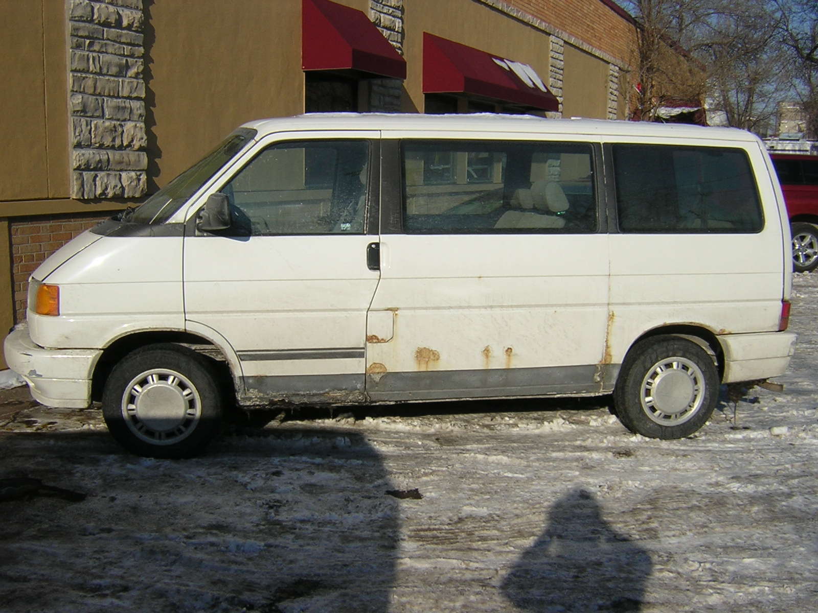

In Minnesota, it's just not really possible to keep a car, driven in winter, free of the stuff. As soon as it starts to snow, they start throwing it all over the road and it gets all over your car -- and worse -- all under your car. Then the temps drop to no degrees, or worse. It's not possible to keep a hose hooked up. It'll freeze. The prospect of hosing-off a LBC, top and bottom is, indeed, a terribly uncomfortable one -- at best. I think "suicide" might be an appropriate term. Let's just say, garaging an irreplaceable old car over the winter makes the most sense.
LBCs are no more prone to being dissolved up here than anything else. It's just that everything that runs in Winter gets wrecked. All the little nooks and crannies get salt in 'em, and every little chip in the paint is exposure.
Here's a pic of my VW van taken in the parking lot just now. Would you really want to do this to your TR?

Dale. Here in Upstate N.Y. we look for cars from southern PA, Virginia, MD, and the like. Even just down by the DC area the winters tend to be far milder than up here. Cars that make thier way up here from that area are in wonderful shape compared to similar aged vegicles from here.
Also, N.Y. is a major producer of salt. there's mines under most of the fingerlakes (mostly Cargill) and they're not afraid to "lay it on" whenever there is a chance of ice.
The rust belts are a regional phenomena. But I'm definatly in the middle of one.
It's not just salt alone that does it. it's the right combination of salt, year round moisture (Corning and Rochester N.Y. have both held the record for cloudiest U.S. city in the past) and periods of freeze and thaw.
The freeze and thaw is the muscle behind the moistures ability to breech your cars rust prevention devices. Such as paint, undercoating, and seams. the salt laden water creeps into all the cracks, then freezes, thus expanding, and opening bare metal up to the chemical reaction.
That's whay all the cars up here are rotting around the welded seams of the wheel wells and rockers. as well as anyplace the road crud accumulates and sits.
Along the coast you never have that Freeze thaw cycle added in, and the factory rust prevention devices stay sound.
Also, all the suspension components that only get a light shot of pant, or nothing at all from the manufacturer, rust up and adjusters freeze solid in no time. The salt may not directly cause the rust, but it alters it and definatly acts as a catalyst.
