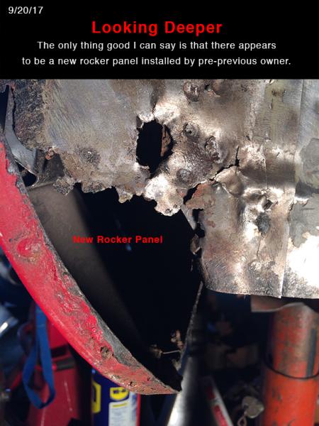

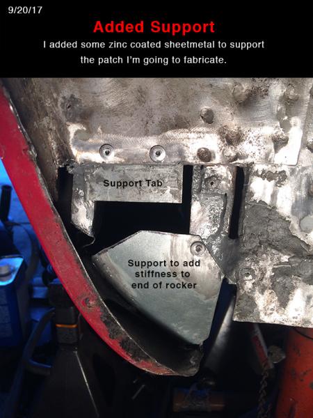

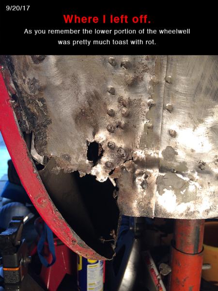

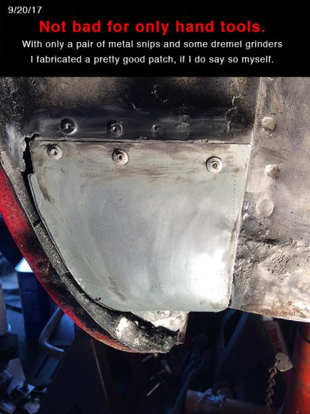

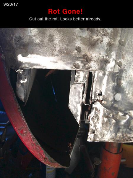

So the saga of the rust rotted wheel wells continues with some great progress.
First let me say that I haven't worked on the car for several weeks. Who am I kidding, months! But once I got back into the swing of it and I see some progress I am getting more excited to get the C back on the road.
I've been working on cutting out the rusted wheel well section that you've already seen and then replacing with a fabricated patch panel. Since I don't have a welder nor do I wish to purchase one and learn to weld I decided that since the section that needs replacing isn't a structural part I could use JB Weld epoxy adhesive to glue the panel in place.
If they can glue parts of a 747 together using epoxy surely my C wheel well panel will stay together.
When you look at the pictures of my progress keep in mind that I'm working with a very limited budget and a standard set of hand tools, wrenches, clippers, grinders, etc. etc.
Welding the patch panel in place may be the ideal way to fix the rust issue, but don't judge until you see the outcome. If I offend any professional body and fender guys with my weld-less panel fix I apologize and I invite you to come on down and show me the right way to do it. At your expense of course. LOL.

quite a job! I for one am very interested in the adhesive - we have discussed it regularly but have not had conclusive evidence! Keep us posted
i don't see any problem using JB weld, but the use of a few pop rivets is also a very good thing. I did patch a small section of my C's floor, about an inch square. Didn't use any epoxy but I did dip the rivets with waxoyl, to prevent dissimilar metal corrosion. Nice job.

If JB Weld is as good as the claims there shouldn't be any problems with the holding strength. As I stated, since this section of the wheel well isn't structural it should hold up as planned.
Thanks for the vote of confidence. I'll let you know if the patch fails in the next 10 years or so. The car won't see any rain or hard driving so it should last for as long as I'm around.
We've used adhesives to fix rotted out floor pans and patch panels. Autobody paint & supply stores have "systems" with the right epoxy. I was a skeptic until I got to do hands-on tests of the stuff. Glued up some pieces of both steel and aluminum sheet and tried to disconnect them with hammer and vise, twisted and tortured the test pieces well. The epoxy held well beyond anything "real world conditions" would do... Now our MGB has been rebuilt using it. Going on ten years ago and it still looks fine, no issues. Used SEM 39747, "Multi-purpose panel adhesive".
Thanks for the input Dr. Most guys say the only way to go is MIG weld, but I didn't have the where with all to buy a MIG unit just for some small non-support panel rust through. I can see the need if the panel is really gone, but for the small areas I have I didn't see any need.
I've always wanted to learn to weld, so maybe some day I will invest in a MIG Welder.
Good to know you have real world experience with epoxy use.
