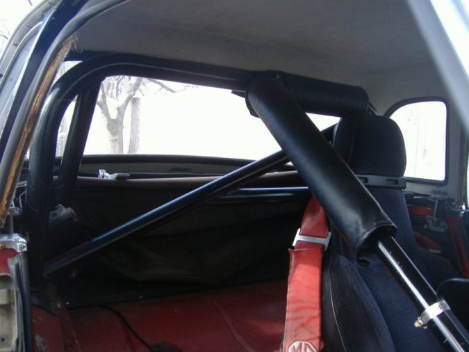

bill_young
I have to agree with the last post, remember to add adequate padding if your head can come into contact. I padded my bar, but only on the drivers side and last year when giving a friend a ride I accidently accelerated too quickly and popped his head against the bar. I'll be more careful as I usually don't have passengers, but if you do pad the entire bar. I used the foam padding that was the requirment at the time and made up my own vinyl cover which attaches with velcro strips.
