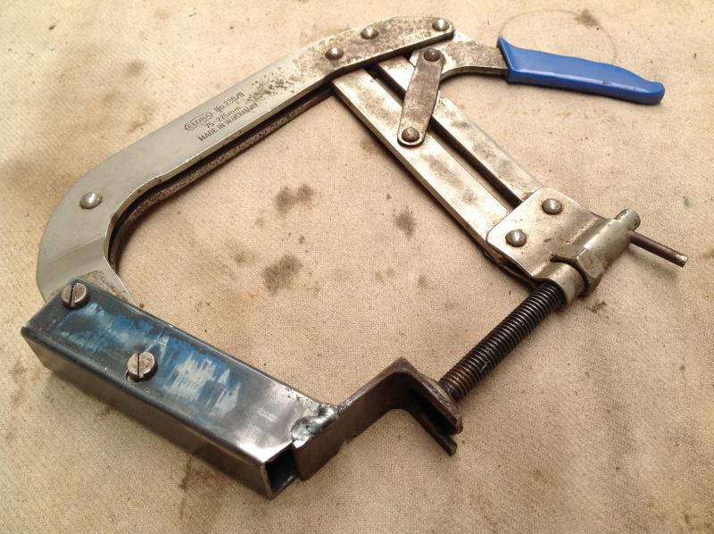

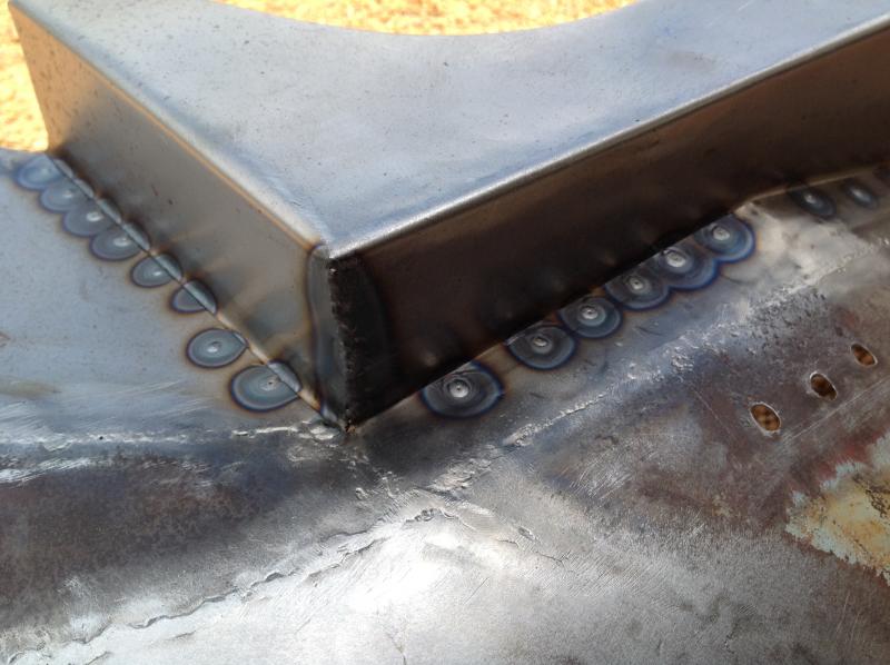

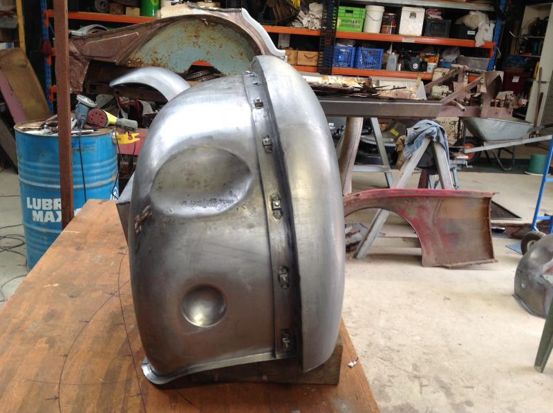

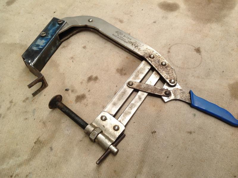

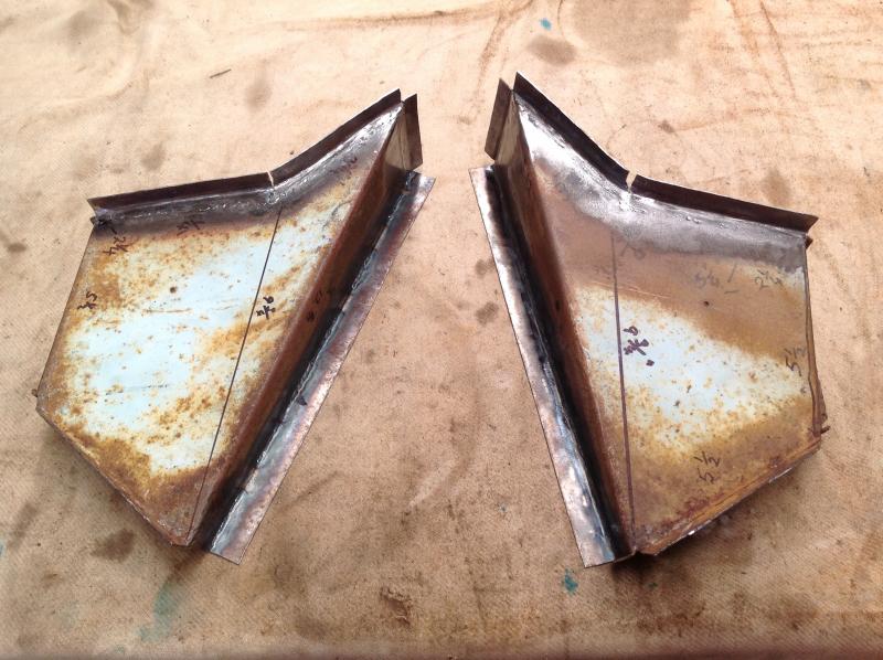

Finally got the left inner mudguard finished and added the cage nuts to both the mudguard and inner guard. Had to fabricate the box section that goes over the suspension turret and this had to be spot welded to the mudguard. Unlike the cage nuts along the edge of the inner guard, the location for the spot welds on the box section were in a fair way and deep, which the Eastwood type of spot welding clamp could not reach. After a bit of thought I modified my valve sprong compressor to make a clamp with the necessary reach.
Worked well and will go into the tool kit for future use. When the need arises I will modify it so the foot can rotate through 90 degrees as I can see situations where it will be required.
The wleds look like this.
The mudguard and inner complete with their home made cage nuts looks like this.

I like the spot weld clamp. Great idea.
The TIG spot welds look very neat.

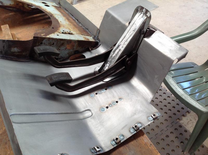

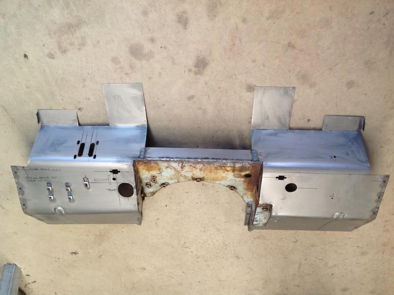

Decided to look back at the firewall I put together some time ago to finish off the detail. At the time I didn't have a satisfactory way to spot weld or a supply of cage nuts so the holes and cage nuts needed to be done. Likewise lots of holes for steering columns and the like had to be sorted to facilitate conversion from left to right hand drive.

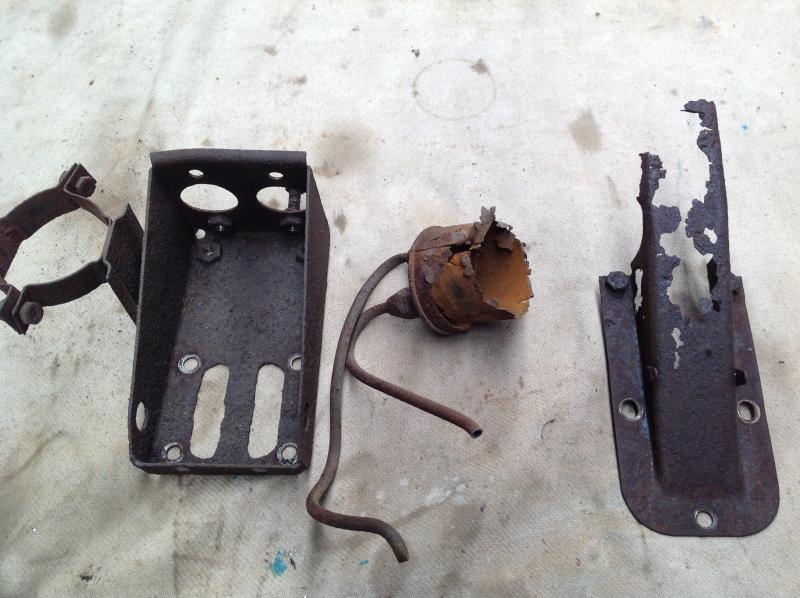

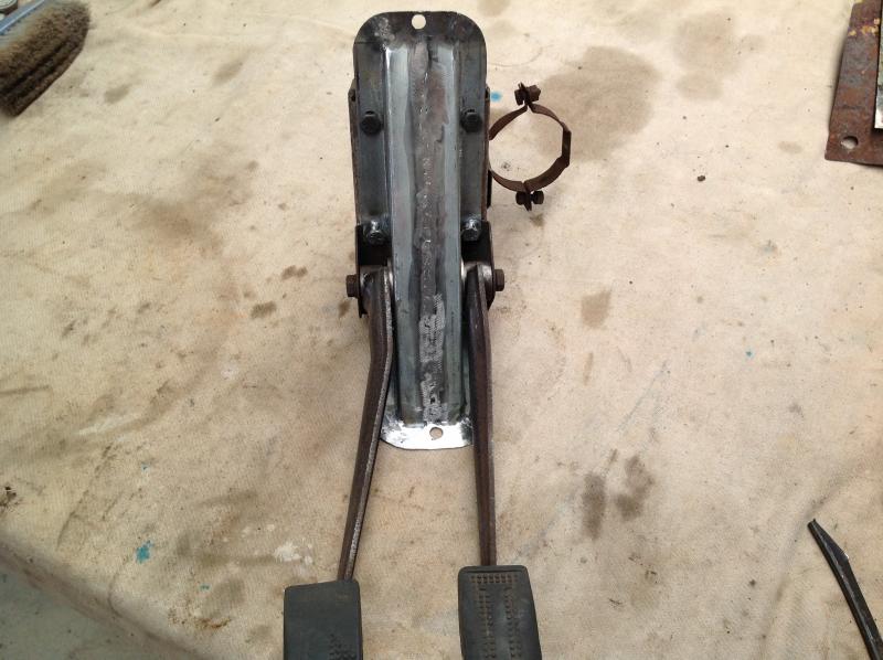

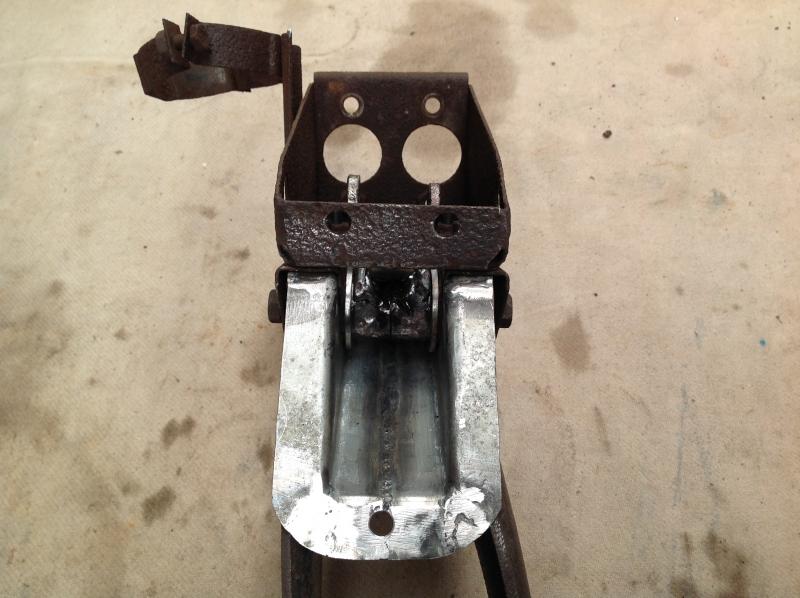

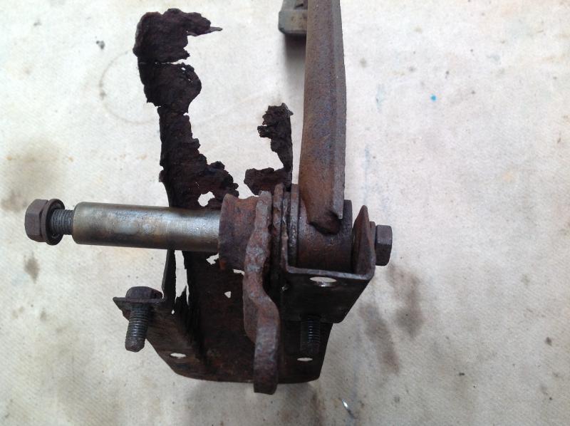

When I started to do the cut outs for the brake clutch assembly I decided to check the fit of the peddle box. Funny how time dulls your memory of the parts you have removed. I'm sure it was better than this when I took it off. Brings up the old question of refurbish or replace? I have decided the brake fluid container wil be replaced.

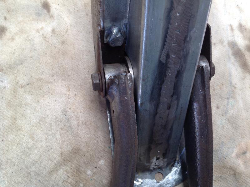

The supporting frame was a bit rusted so I decided to fabricate a new one. Made it from RHS which I had to cut down its length to adjust the width of the assembly from two inches to one and seven eigths inches. This was good because it allowed me to bend the flanges and then weld the two halves back together.

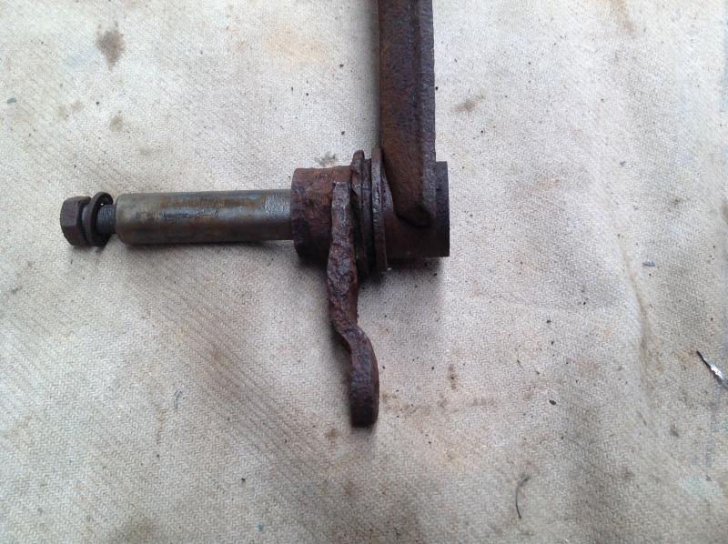

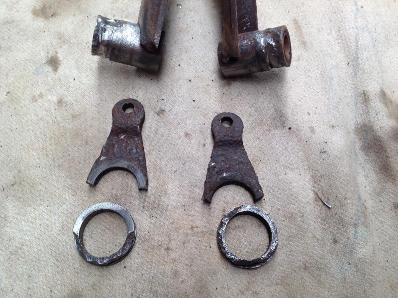

Unfortunately the peddle assembly was fused together with rust. The peddles pivot on a shaft which hangs in two bushes which are clamped in the frame. One bush turned in the peddle and the other was totally locked. Both bushes were eaten away with rust.
You can see the grooved bush between the peddle and the actuating lever. Unfortunately the bush is locked in place because the lever is welded on after the bush is put on the shaft. I decide I need to disassemble both peddles and replace the bushes. This required an angle grinder to cut the welds on the lever.
I turned up two new bushes on the lathe and then welded the levers back on the main bosses. Reassembled the peddles into the supporting frame. If you cross your eyes and squint you can see the new bushes between the peddles and the frame.
Finaly back to where I started from! Dry fitting the assembly to the firewall to ensure the holes are in the correct places.
Two days work! Maybe I should have bought one!
now to get back to my firewall.

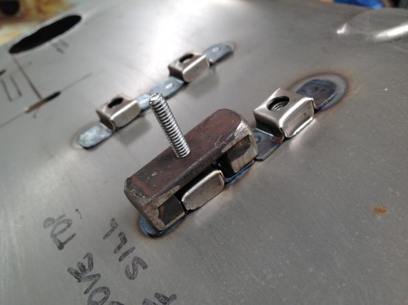

To continue the spot welding saga.

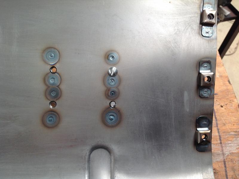

As they say about necessity and invention. I needed a way to spot weld the cage nuts that were in the middle of a panel where my clamps would not reach. The critical thing is that the two sheets of metal are firmly pressed together. Commercial wleding gear clamps and then weld in one process. Amateurs clamp and then weld. (Eg me) Day dreaming about how I would do them and came up with the following.
Two bits of heavy plate welded to a flat bar. The bar is threaded in the middle to take a gutter bolt that will pass through the cage nuts. When the bolt is tightened it holds the cage and nut in place and also acts as a heat sink for the spot weld. In the following photo you can see the head of the gutter bolt and the spots where welds have been completed. To the right are several cage nuts spot welded in place with the modified vice grips as these are near the edge of the sheet.
Very neat spot welding fixture Need to remember that trick if I do another car.

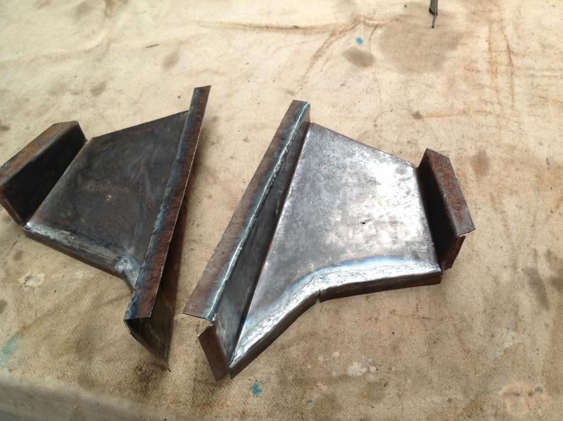

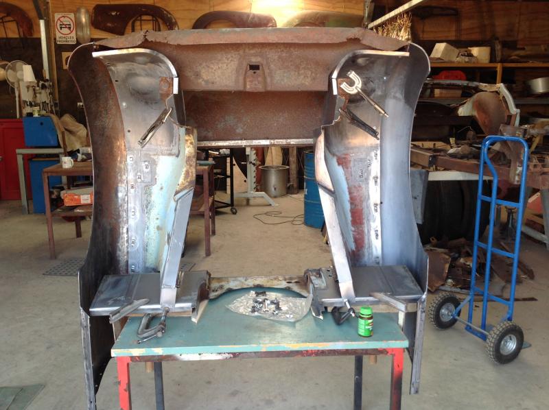

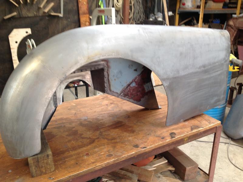

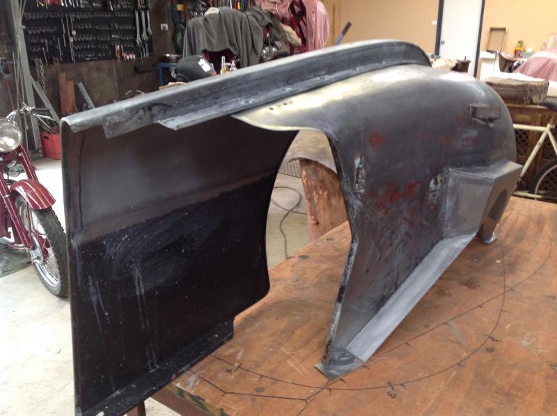

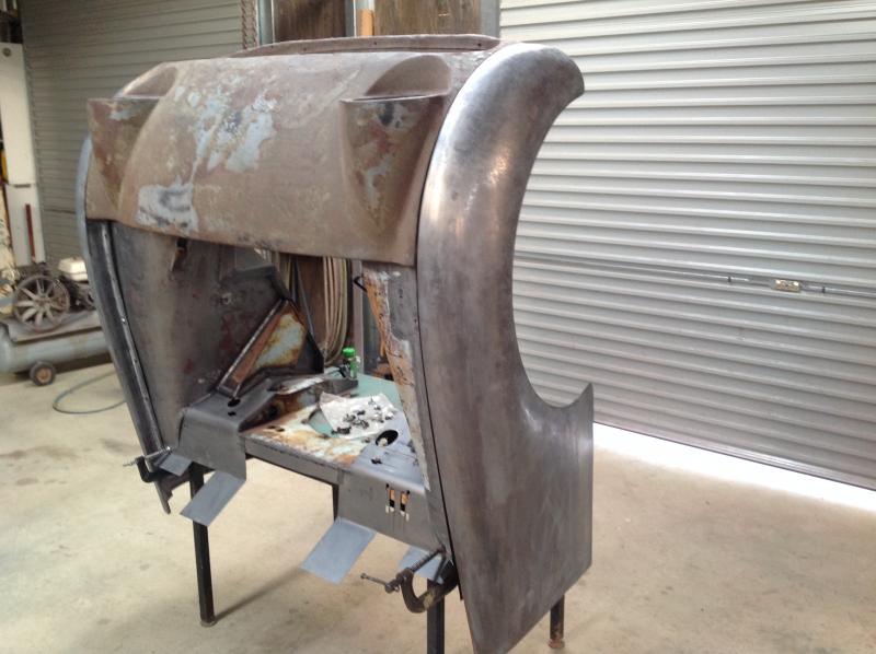

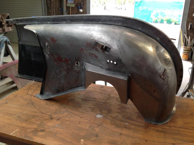

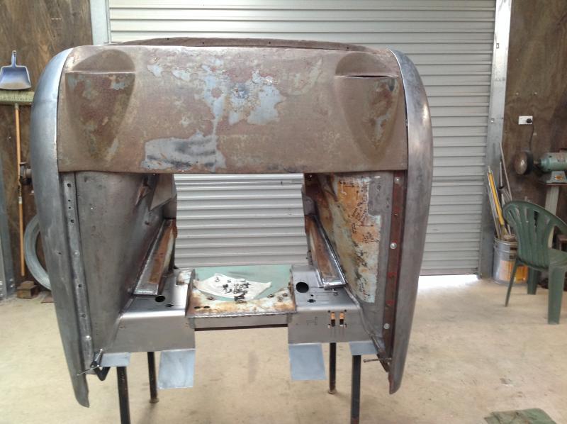

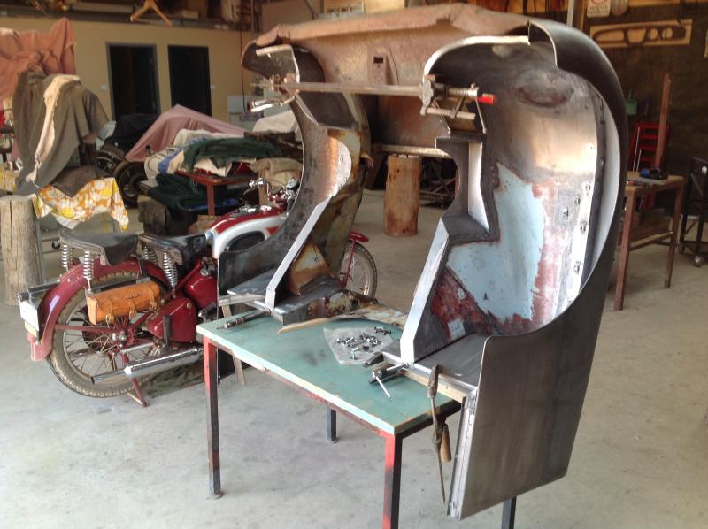

As my old boss would say, Assume Nothing! When I was removing the inner mudguards from the firewall, the rusted state of the guards lead me to assume the box brackets that strengthened the attachment between the guard and firewall would be eaten out with rust inside. Accordingly I decided to simply cut off the flanges that were welded to the firewall, thinking I would have to fabricate new box sections. Of course Murphy's Law came into play and both brackets were nearly perfect inside. I have just spent some time re-making the flanges for the perfectly good box sections.
Some would say day dreaming though I call it dry fit up of the parts. This is what it looks like now!
The front cowl is one of five I have. Still to decide which I will use. The bike in the background is my 47 Triumph Speedtwin.
