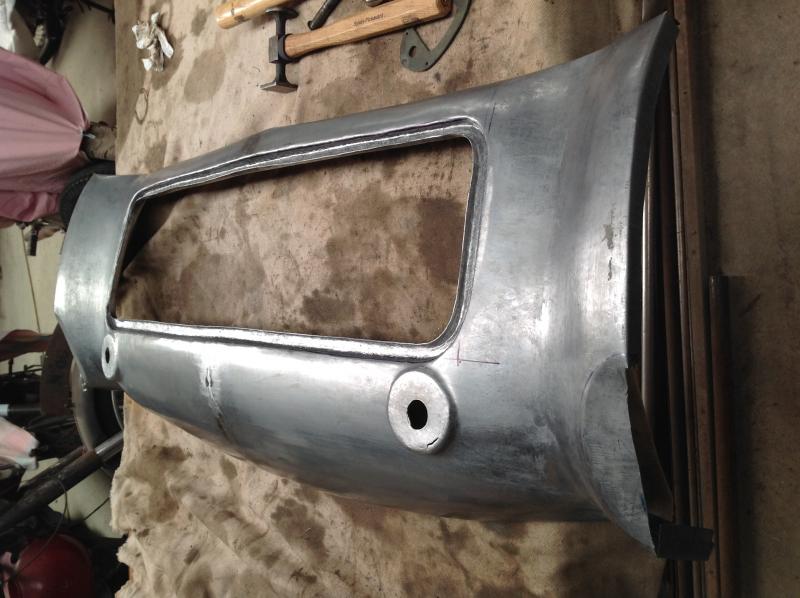

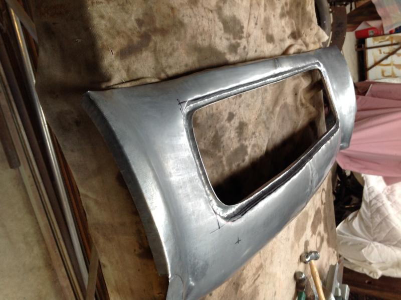

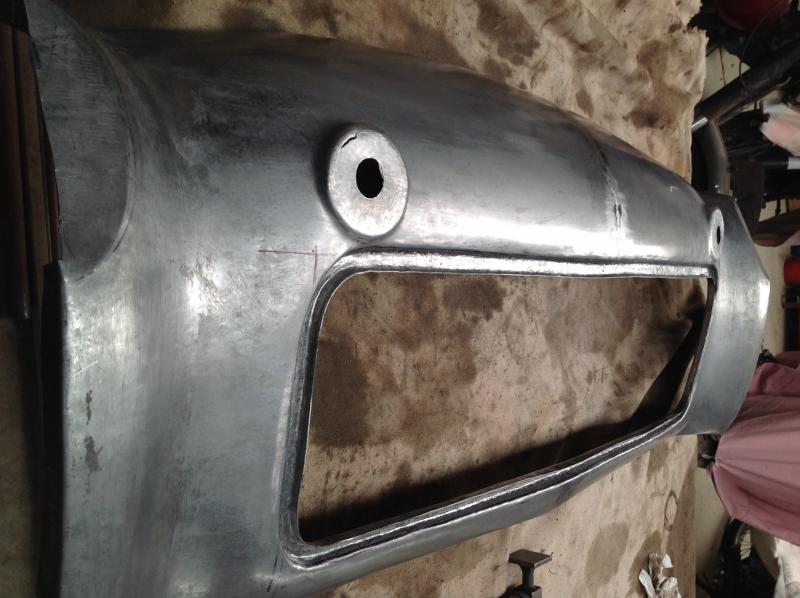

Finally got to play around with the plinths for the indicator lights. If you look closely you will see a small slit in the top flat section where I got a bit over zealous working the metal up. Doesn't pay to hurry the metal. Nothing that the tig won't fix. Called it quits after that although I would have liked to raised them a little further. Most of the work was done with a small blocking hammer on the sandbag and then the sharper edge defined with an old cup head bolt shaped on the bench grinder. I have a range of bolts I have shaped now for doing tight relief corners. Pardon my terminology as I'm not sure of the correct terms.
Likewise, although the channel is not finished yet, most of the shape has been done first on the sandbag and then the lip turned up over a piece of 3/8" steel plate held in the bench vice. Again the channel on the corners was worked with another old bolt shaped to fit in the bend.
Doing the channel has flattened the curvature of the overall panel and so I am going to make a roller to allow for the curve to be worked back into the panel, a bit like wheeling the panel but only along the channel. Hope it will take some of the tooling marks out of the channel as well. Had to have a go at making the channel just to see if I could do it. I know some people will make the channel separately and then tig it into a cutout in the panel. This was going to be my fallback plan if I messed up the channel.
Very nice! The little bobble on the top of the plinth is seen in many of the factory panels too. They used lead to cover it, but I bet you'll do better.

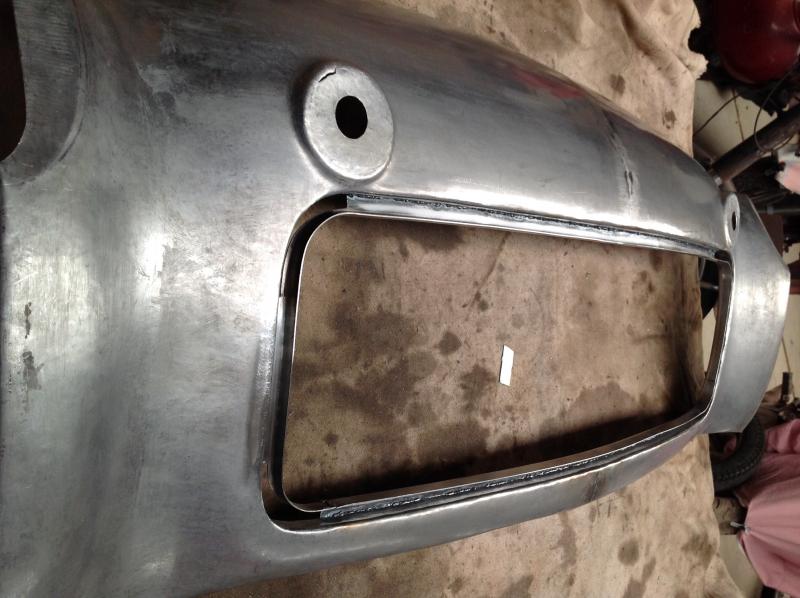

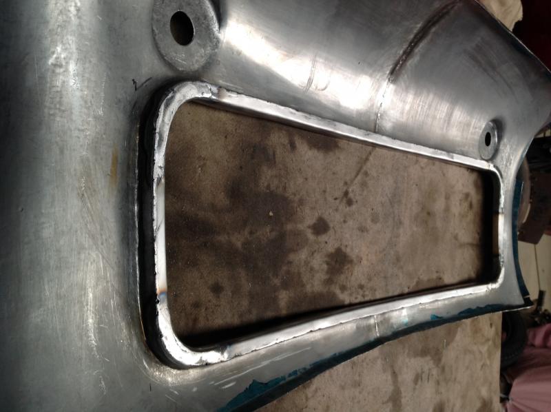

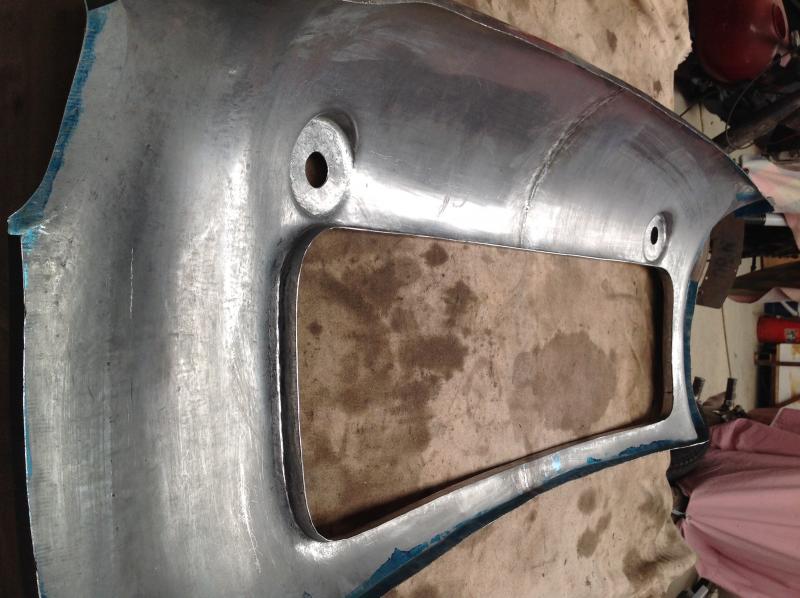

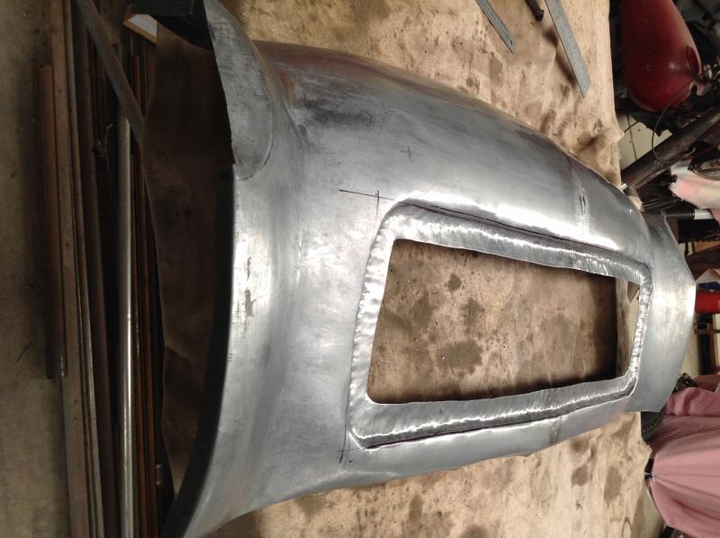

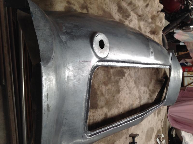

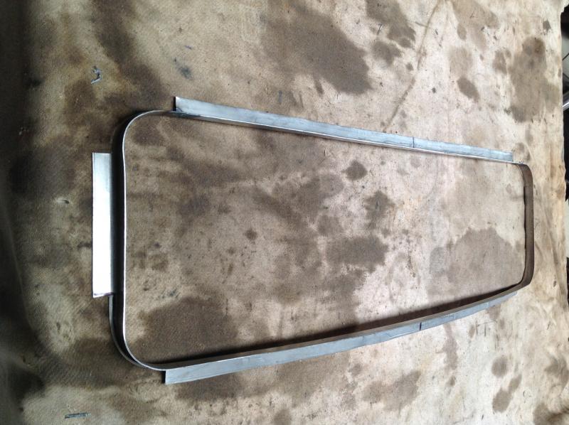

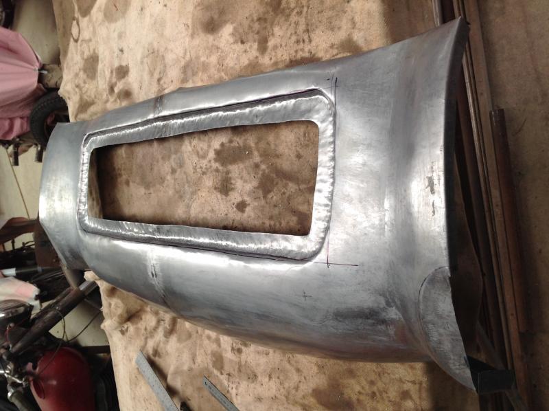

I decided on a tactical retreat with respect to the channel around the spare wheel enclosure. Having chased the channel in, I realised that stretching the side walls of the channel had flattened the profile of the panel and the only way to get the shape back into the panel without damaging the panel would require shrinking the back of the channel. Too hard for me to do with my limited facilities and skills. I cut the base and the lip off the channel so I was left with a flange on the panel around the opening. This allowed me to shrink the flange and bring the curvature back into the panel. I have been using the door of the enclosure as my guide for the curvature as it fits neatly in the existing car panel.
I then made a new back and lip for the channel. This allowed me to curve it to match the panel by stretching the lip. It was also nice and straight with minimal tool markings, unlike the previous channel
This was then tigged into the opening which left the welds on the inside. I used several pieces of half inch tool steel to set the width of the channel when I clamped it in place for welding. The back of the welds will be covered by the spare wheel carrier and any weld through will be behind the rubber seal for the door of the enclosure.
Welded the corners in separately rather than create the corners by stretching the outer edge. Too much hassel with thinning of the corners with stretching.

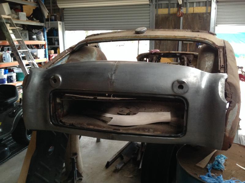

Flight of fancy to see what it will look like on the car eventually. We refer to this car as my thirty year project. Will no longer have a drivers lacense by then. Got to start thinking about what I work on next.

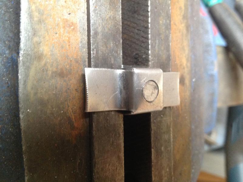

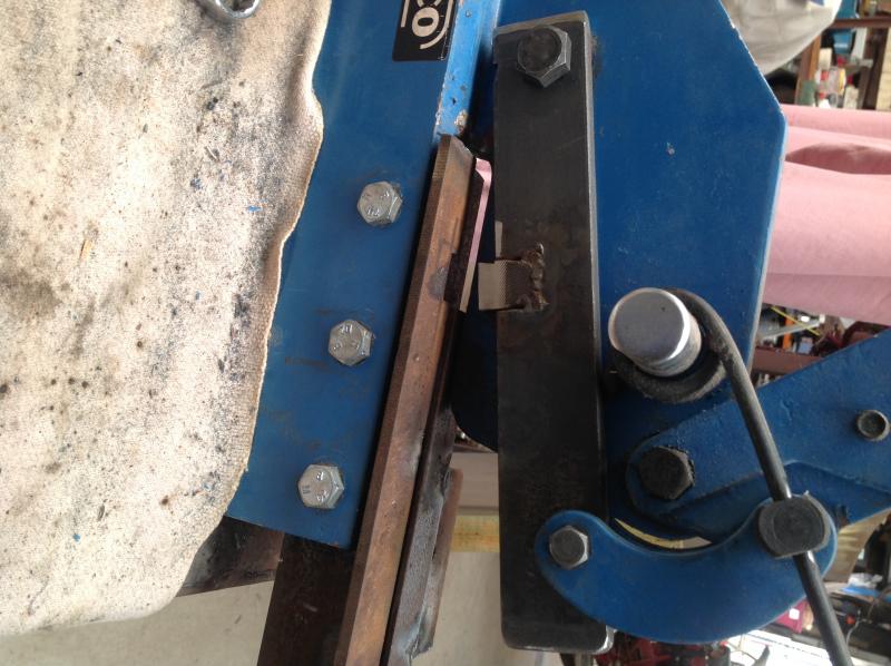

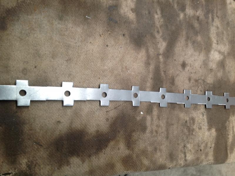

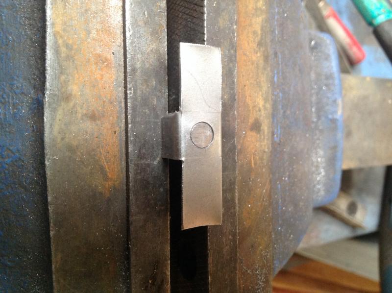

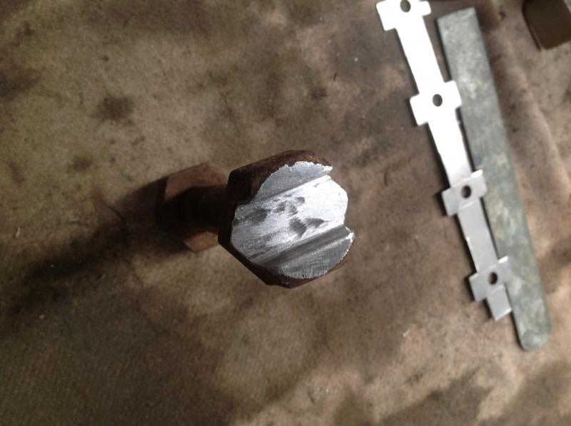

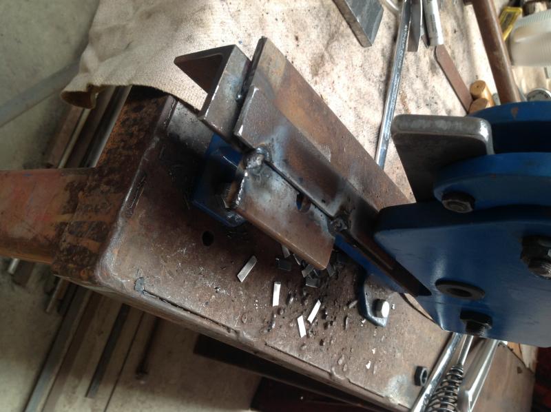

As an exercise I thought I would have a go at making the cages. I have a cheap HF type bench shears and thought I might be able to adapt it to punch the sheet metal. To cut the whole cage would take to much force so I opted to punch the edges out of a strip. I used an old file to make the cutting die and the female form it punches through. The die was set into a blade I copied from the original blade in the shears. The die and the form were fabricated with an angle grinder and bench grinder. I clamped the cutter between several heavy pieces of metal as heat sinks while I tigged it into the shear so the strength of the cutting edge would not be harmed. The shear is simply a length of 3/8" flat bar. The female form is welded to a length of angle bar which bolts to the frame of the shears. There is a fixed fence to set the depth of cut in from the edge of the strip of sheetmetal. The blade has a detent at the back which sets the position of the cut so I can feed the sheetmetel in and the next cut is set up ready.
Sorry but still can't make sense of which way a photo taken on my iPad will upload.
The head of a punch for shaping the cages over the pedestal. A perfect example of the angle grinder as a precision milling machine. (It does the job! Happy to accept donations of a milling machine for my next project)
Resulting strip after punching and drilling the bolt hole. Initially I anticipated making a punch to press the holes but found marking, centre punching and drilling the holes didn't take much time. Since the bench shears are currently re-employed, I separated the cage blanks with hand shears.

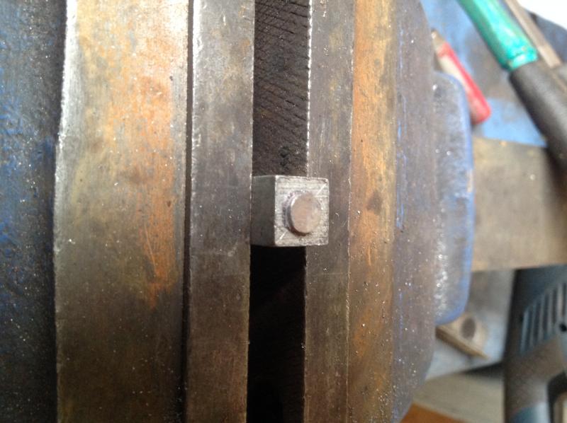

Half inch square pedestal to shape the cage over.

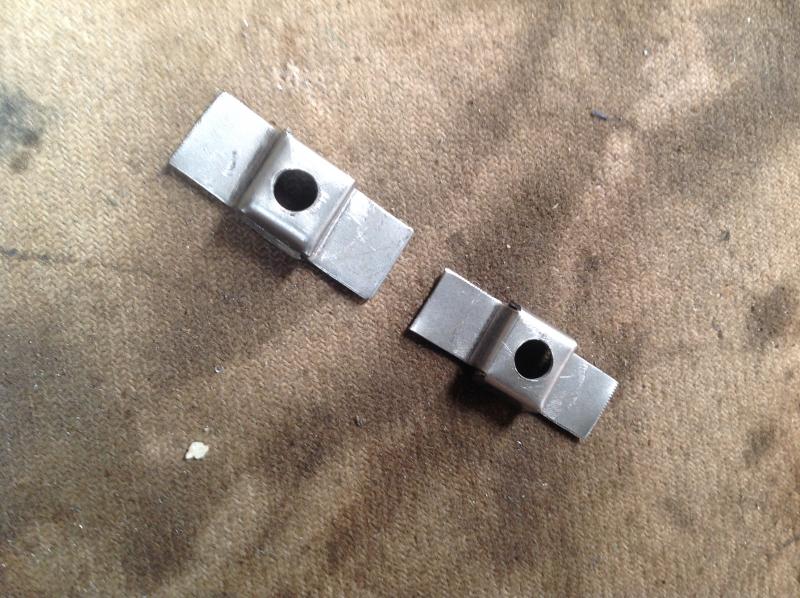

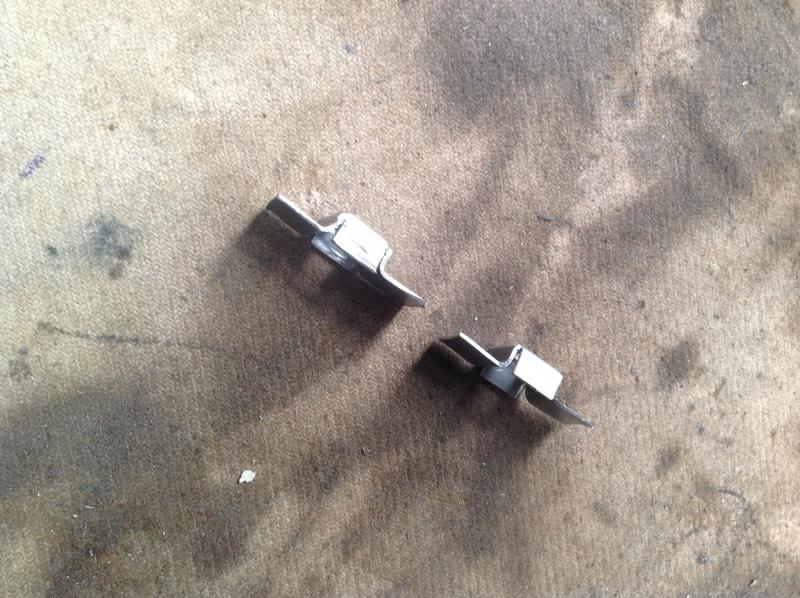

First bend with punch
Second bend with the punch.
First two attempts. First one a bit rough as I sorted out the depth necessary to puch the sheet down.

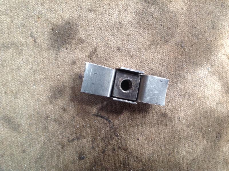

No problem with the nut falling out. 10 done, 90 to go!

Impressive work with such limited equipment. The cages look every bit as good as the big 3 cages.
The nuts may be easier to do on the drill press. I worked with a guy that had to produce a lot of special nuts. He would create the nut blank with a hole then had a machine tap with a long parallel shank so he could just put the nut blank in a fixture to stop it turning then tap through the nut leaving it on the shank and tap the next nut. Would have 10 or 15 nuts rattling around on the shank before he took the tap out of the drill press and dumped them off the shank. You need good tapping fluid to do that.
