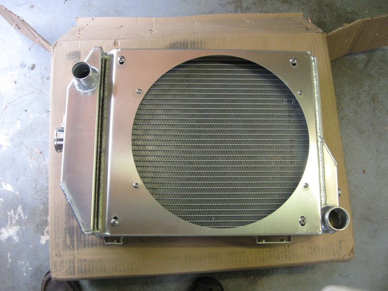

On ebay there are aluminum radiators that are made in china. There is a three row version. I have installed one in my car and one in another person's bugeye. They are a drill/file to fit application, but so far they have been working well. Mine cools my 1275 superchagered bugeye.

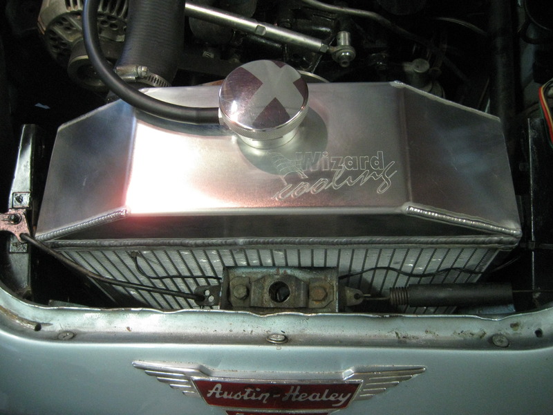

No doubt, that wizard cooling radiator looks well made. It simply didn't fit in my budget at the time.

The Serick Motor Sports unit is interesting, but at 365 pounds sterling plus shipping, why not go with the bugeye guy piece that looks very similar.
Looking similar does not make the radiator perform similar. There are a multitude of different cores that could be used in these. The gauge of aluminum, the type of connection between the core and the tank, the tank design, the type of radiator cap, drain plug, temp fitting, and general quality control.
The Serick unit is obviously a bespoke item and no doubt they would stand behind their work. I'm guessing wizard cooling would also stand behind their work. An ebay special is just that and nothing more. I have no idea about "bugeye guy" radiator. If I had to guess I would say that he is selling the same radiator that you see on ebay that he has already drilled and filed to fit. But I'm just guessing.

This is the one I have used:
https://www.ebay.com/itm/ALUMINUM-R...ash=item4d5e9cd34b:g:4T8AAOSwR5dXRR2p&vxp=mtr
I think it was a bit cheaper when I purchased them. They look nice, but are no work of art. They do require drilling the mounting holes and possibly filing some edges and corners. The drain plug is plastic, but you could replace it with a stopcock.
I purchased it because I was low on funds and time. I was pleasantly surprised. Not craftsman quality, but certainly not a hack job either.
