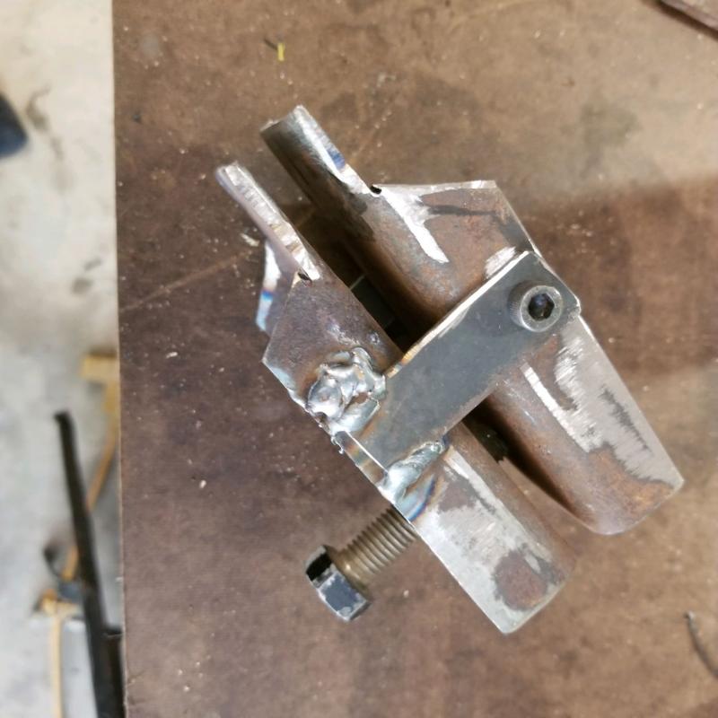

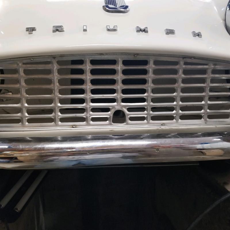

When I was having temperature problems one of the things I did was to open the grill openings. I believe I saw about a 5 degree drop in temperature from this work. The solution to my issue was the lower temperature thermostat.
In the grill photo you can see the difference in opening by comparing the short slots by the starting handle hole to the rest of the grill. I made a tool to allow me to carefully squash the bars in the grill.
The tool.
