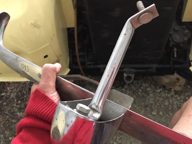

1/. I have two new stays for the rear fender, courtesy of Moss about twenty years ago. They are still listed, but I can find nowhere on the car to attach them and Moss does not seem to know either. Any suggestions?

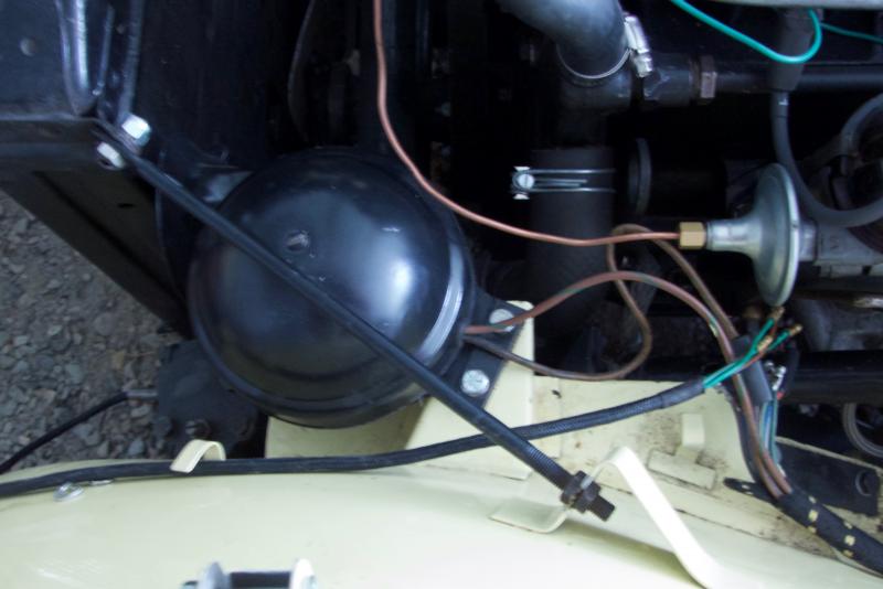

2/. The radiator stays seem to rest on the horns. I am sure they should not! The rad lines up nicely with the engine, so does this mean I should raise both, or just the radiator. How much space should there be there? or can I just bend the horns down a little?

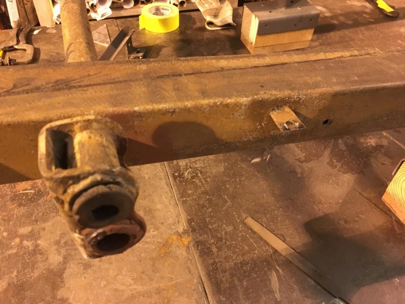

Hi Dr. Mike, I think this photo showes the small bracket for the brake cable. The bracket is located on the passenger side at the rear of the prop shaft tunnel, under the passenger floor. The prop shaft tunnel has already been removed in the photo. My frame has tabs welded to it for attaching a flat metal strap between the frame and the bottom of the rear wings. I can get you a photo tomorrow when I get to work and I will post it tomorrow afternoon. I am not sure if that is what you are describing. Frank

I confess that I had not looked at the frame for a place to anchor the fender stay so I shall look tomorrow. I had expected it to be on the body.
i will let you know!

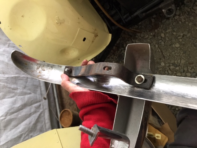

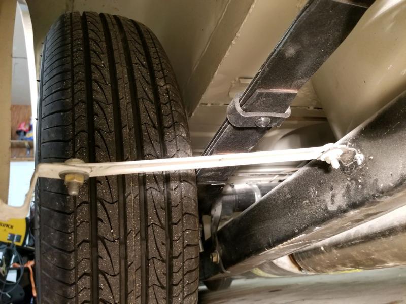

you can see the two tabs at the rear of my chassis where the rear fender supports are attached.
Graham That photo came out very small and I can't post a larger one sorry
You can see the tab on the chassis just in front of the rear spring mount. It is directly opposite the tab on the rear fender, so the brace goes horizontally from the fender to the chassis.

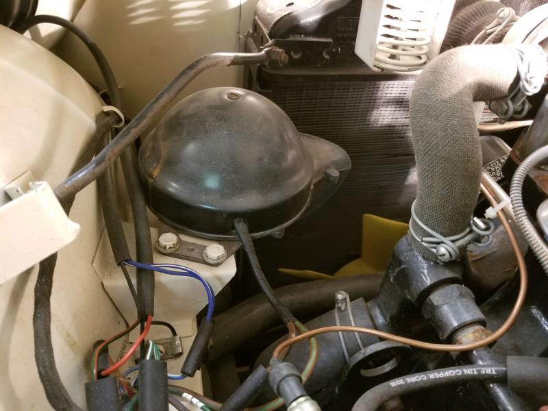

If your radiator lines up with the engine, then do not adjust the stays to clear the horns. As you suggested, simply bend the horn mountings down slightly until the horns clear the stays. It is normally pretty close...and the horns have to be removed to work on a lot of the parts on the front of the engine bay.
I think Graham and Frank have you covered on the other items...
Looks like Lionel beat me to it but here is another picture of the tab mounted near the rear spring mount. This is the passenger side.

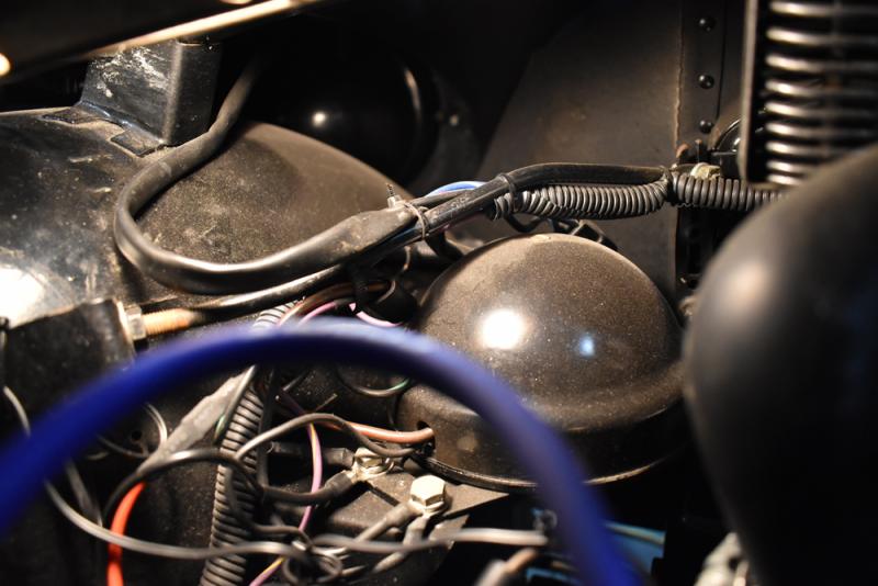

David those are nice photographs! And you add some clues as to how you dealt with the radiator-horn interference

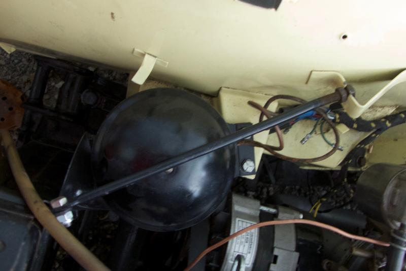

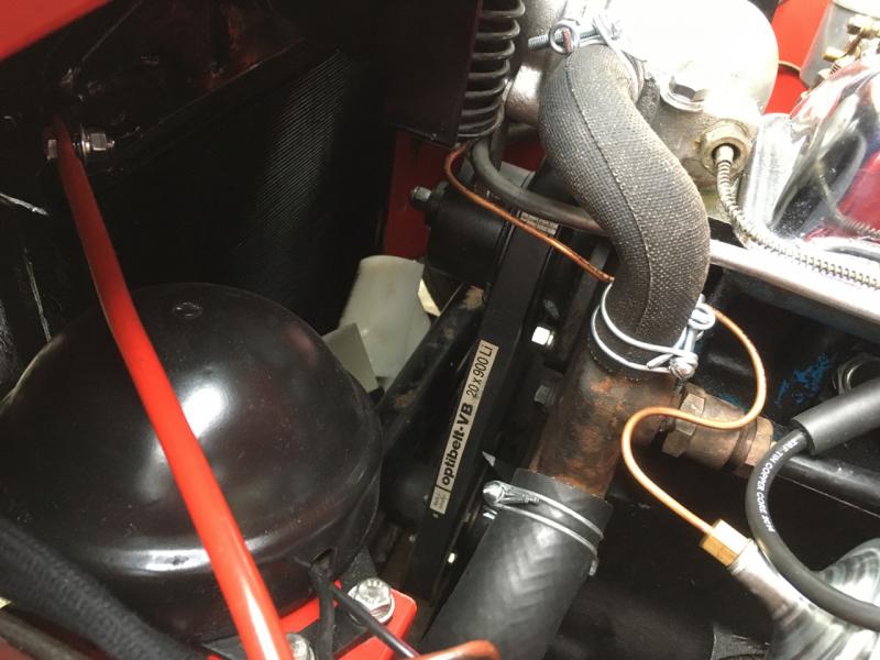

Interesting...David, you had to bend your strut to clear the horns. I’ve never had to do that. My support rods are perfectly straight:
Well...never mind! I just reviewed views of my 1960, and it did, indeed, have bent rods. So Mike, I stand corrected...the later cars used bent support rods, but I do not know when the change happened.
John; there sees to have been a change in the mounting of the horns. Yours angle much further inward than David's ( and mine). the radiator stay goes almost over the top ( North Pole) of David's and my horns. Car #TS 60014 if we believe the attached plate, and I found the body numbers too after 20 years MIA. Just another British diversion to keep us on our toes?
I will try for a pic in the morning
Mike
... So Mike, I stand corrected...the later cars used bent support rods, but I do not know when the change happened.
My car has the bent rods and is TS23677. A likely change was at TS22014...Introduction of the TR3A.

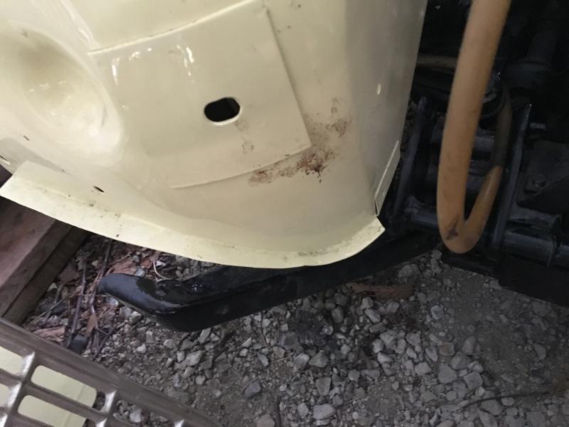

attached Pics from TS60014: horn mounting quite different from John's, and the stay rests in a slot so that it can easily be got out of the way, unlike John's which goes through a hole in the bracket.

The third pic is a reinforced hole on the front of the inner fender: The only use for this seems to be to attach the fibreboard air diverter so more air goes through the editor ( oops, "Radiator"): probably not needed here!

Isn’t that for one of the bumper braces on a wide mouth?
Aha!
you are quite right, and thank you. I dug out the front bumper and there it was: brand new with overriders and their stays attached.
