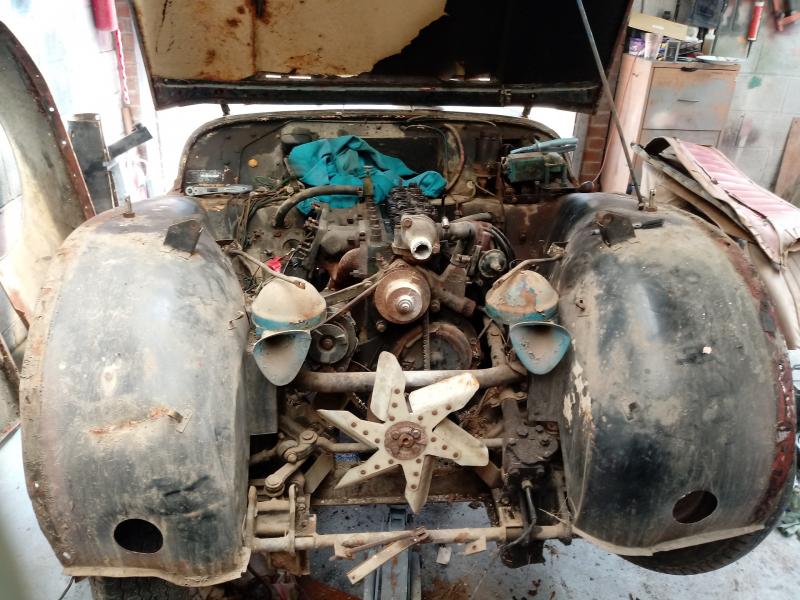

I think you will find there are right and left hand horns and opening of the horn is not into the radiator, but in the void between the fender and the radiators. I could be wrong, but that is how I do it.
steve
Hi . This is my 1957 car , TS/20934 as i stripped it
, horns facing front
Hi Tro8 nice solid looking car. I see it still has the tie bracket for the small mouth. I think the 1957 small mouth mouths were the best car Triumph made. Do you know where or what the fan came from?
