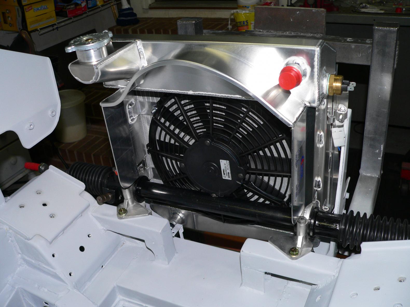

That’s a good question, the down flow radiators for Bugeyes use ½ BSP. I research this and concluded that if you want options then don’t go down that path, not many to choose from. I had my radiator design to accommodate a 17mm bung to have many options if I choose. Right now it’s set up to operate at 70c & 75c.

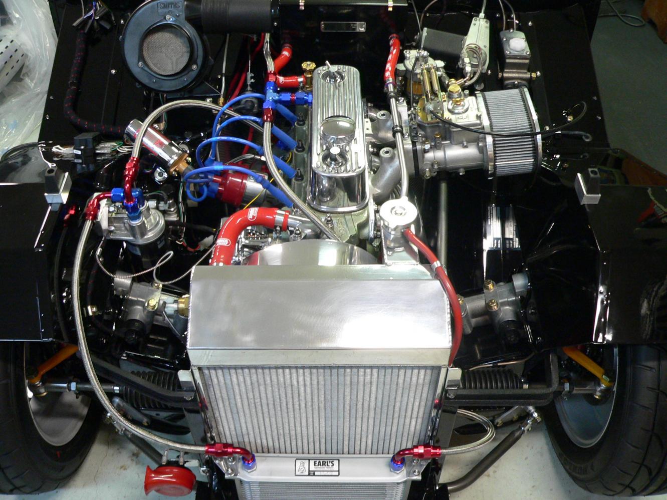

Griffin radiator is 10 min’s from my front door. I wanted my radiator custom built here in the USA but had a horrible experience with Griffin. I knew of Ron Davis radiators built quality so I called with some questions, they said that they would get back to me with a quote and answers. The following day late Ron Davis called with their quote and answers, one was the standard bung size 5/8” 18.
However, I already knew the answer, because the day before I was chatting with a friend who was running a Serck Motorsport radiator in his Bugeye. I told him about my experience with Griffin, his answer was go to the mother land and get something that will fit perfect. Early the following morning I was on the phone to the UK speaking with Roy at Serck Motorsport https://www.serckservicesmotorsport.co.uk/p0/austin-healey/187508.htm who is the sales and production manger.
The same questions were poise to Roy and a very quick response “Oh” that’s easy it’s ½” BSP. I knew right then who was going to build my radiator; they gave me an exact quote with precise answers. What was so impressive was everyone here in the USA wanted payment up front, Roy said they only take payment after customer was satisfied.

Sooo...Bluemax. Disregarding thread size where is a good source for the thermostatic switch that will turn the fan off and on? I looked about a bit when I was putting my Datsun swap together and couldn't determine if they were to be used in series with the fan motor or through a relay or what the current requirements would be. I ended up with the over the counter generic parts store kit that is supposed to have a probe through the radiator fins. I ended up using a hose clamp to clamp it to my top tube that I made up out of conduit and it works fine. Don't completely trust it though and would prefer something that actually went into the water passage. Actually would prefer something that monitors the temp for that fan at the bottom hose. That is where I have seen Nissan do it on their newer vehicles. I'm monitoring it on the top of the system and if one was to lose coolant I don't think the fan would run.
Kurt.
BlueMax
Kurt, if you are going to disregarding thread size on a threaded thermo fan switch. I would look at the 77 VW Dasher or 76-77 Rabbit. You have four temperature options to choose from. 17mm 1.5
