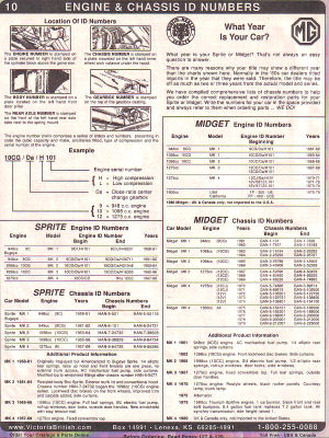

Probably better than a photo would be the numbers off that plate just behind where the generator/alternator mounts (See VB catalogue pp10 - below). Is the single carb on the left or right side of the engine?
On the right, it is probably a 1500, and on the left, a Morris!
