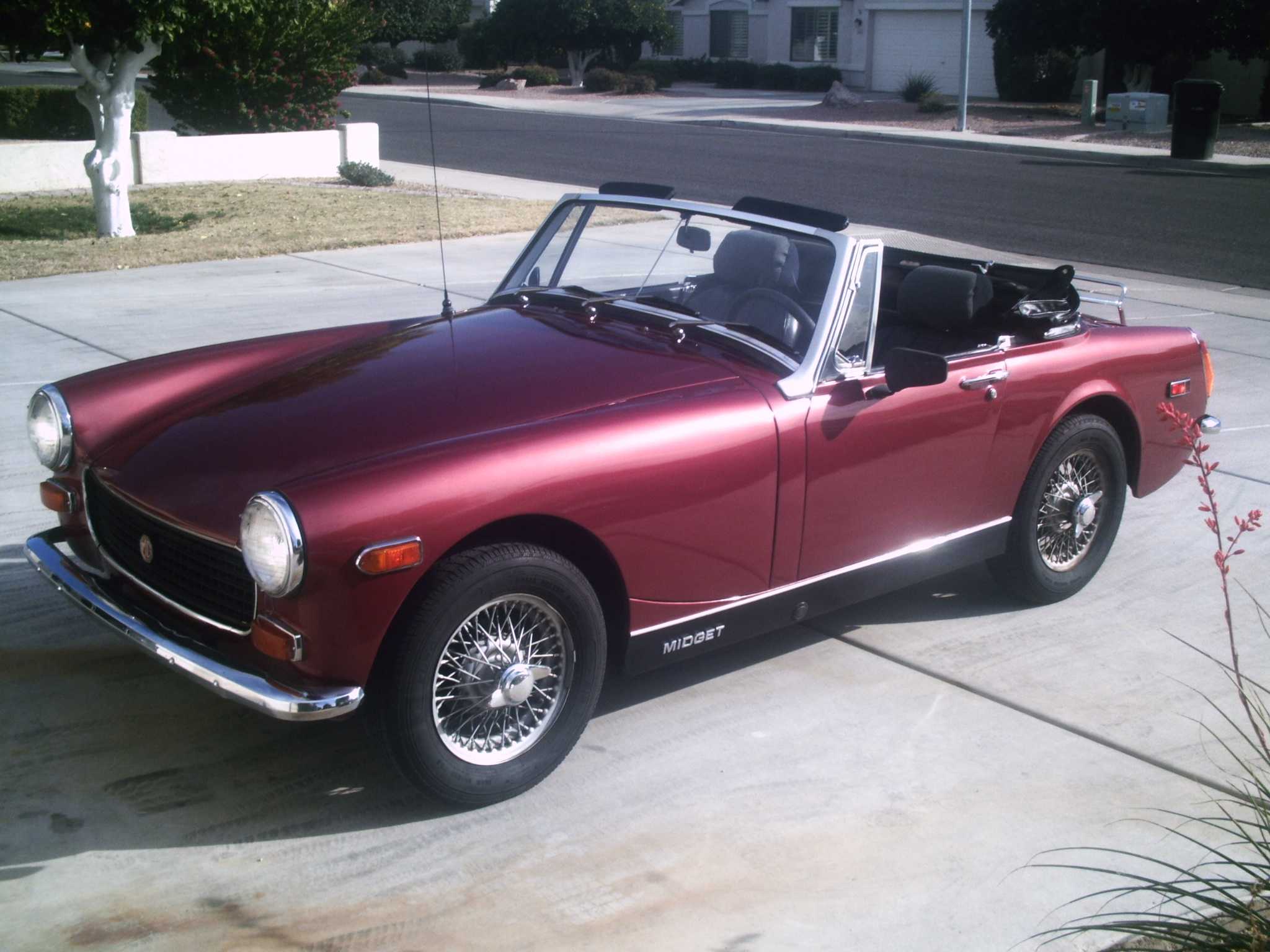

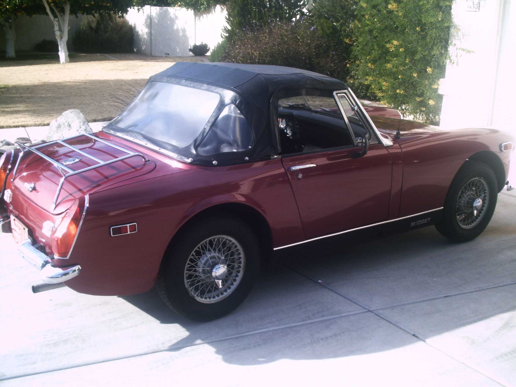

Looks like a nice car with potential. Do you want some advice on folding the top down, or have you figured it out since that photo was taken?

In the attached photo, the six tennax(sp?) fasteners where not unfastened.
1. undo the inside snaps and windscreen clasps
2. undo the velcro and three tennax fasteners on each side
3. pull the top back while pulling the material away from the frame and laying it on the trunk(boot)
4. fold the "wings" (side windows) up onto the top material
5. fold the top material back over the fram and tuck into the cockpit.
Someone else might do a better job explaining this.
I only mentioned it, because it took me a while to realize there is a better(neater) way to do the job.
