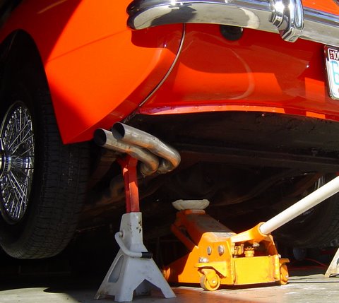

Ed_K
It is not quite as loud if you run pipes to the rear of the wheel before making the exit. There is never any carbon build up on the bumper this way either...
