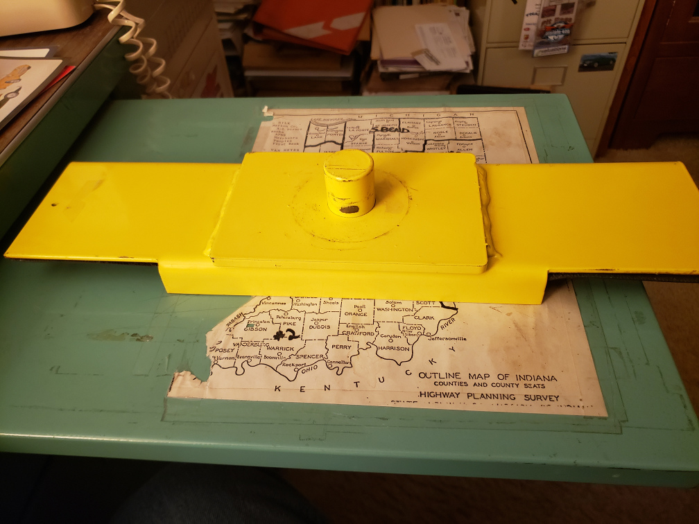

Would like to know more about the U-shaped jack saddle specifically made for Healey. Is that something you made?
I'm going to guess that it was made by Lynn Cline (Classic Collectables Co). Lynn's no longer with us. Here's a couple of photos of mine.
Bob--
Yes, I got it from Lynn some years back and only wish I had bought it earlier when I did not know how easily the crossmembers can be deformed.
I have a friend who said a few years back he would fabricate and sell one for about $75.00.
