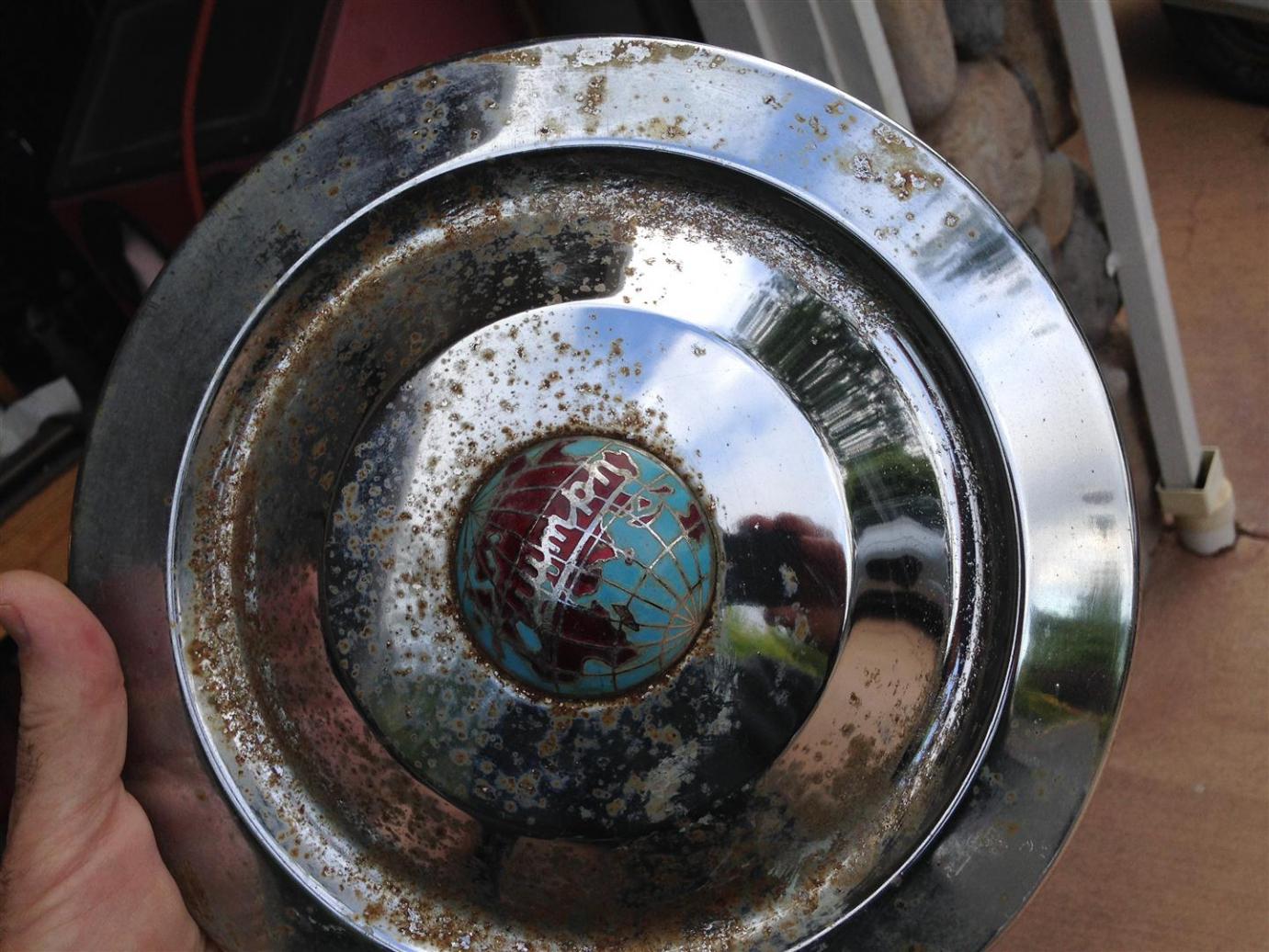

I hit a small area of this badly rusted hubcap with metal cream polish and foil. It looks pretty good for about 30 seconds of scrubbing. Chrome shop would want between $75 and $100 each to plate them.
Pat
sorry for two pics. I can't seem to delete one of them.
