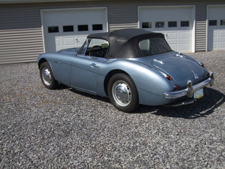

Course if you want something that is really a lot easier to clean get aluminium Mini Lites. Of course it is obvious that my car never had center lock hubs. When I bought it it had good old Austin original solid disc wheels with small chrome Austin Hub caps. I believe I have read in one of the tomes or other that Austin Healey's original specification for wheels was disc wheels with lug nuts on 5" centers. That's what mine had when I bought it. Delivered to Germany. But a very high percentage if not almost all Healeys sent to the U.S. where spec'd with wire wheels. Not surprising huh.

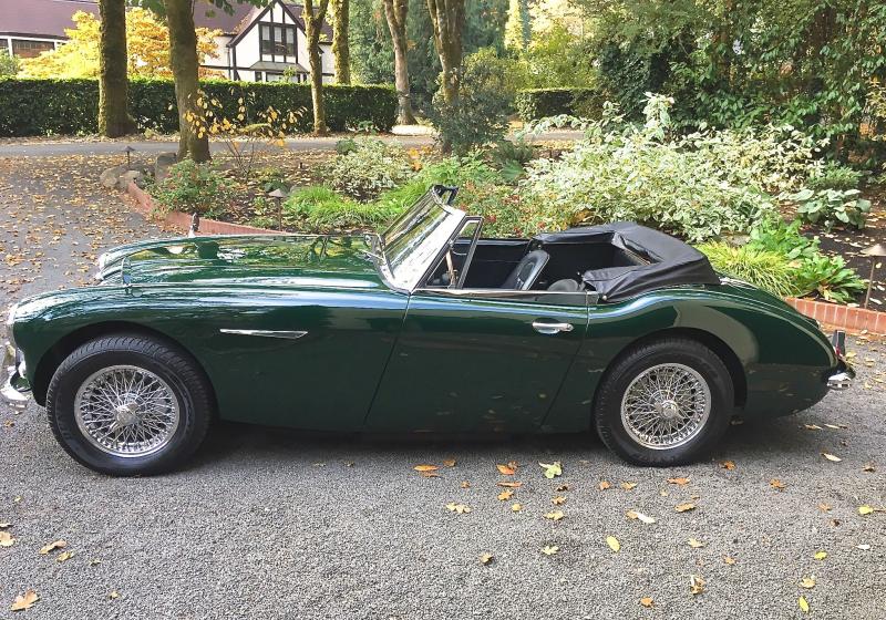

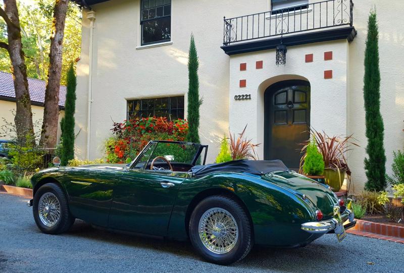

Chrome/Stainless wheels really make a BRG Big Healey.......
