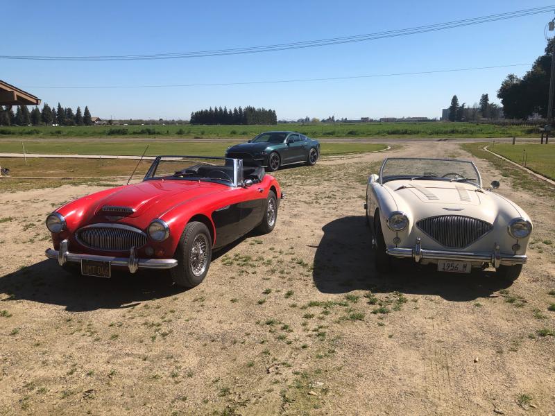

My BJ8 has 6" wide Dayton 72-spoke chrome wheels fitted with Vredestein 185/70R-15 tyres (they're about all you can get for a reasonable price in that size, at least on this side of the pond). The only issue is the rears can very slightly rub against the bolt heads for the rebound box when I corner very hard. My BN2 has the original, painted 48-spoke wheels fitted with 165/80*R-15 Nexens (I think they're 80s):
