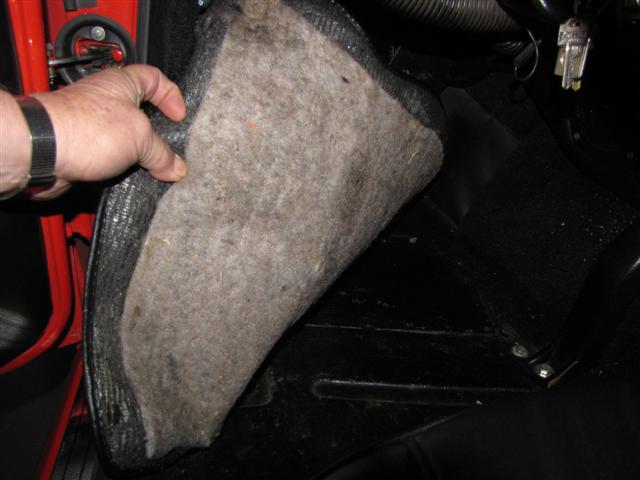

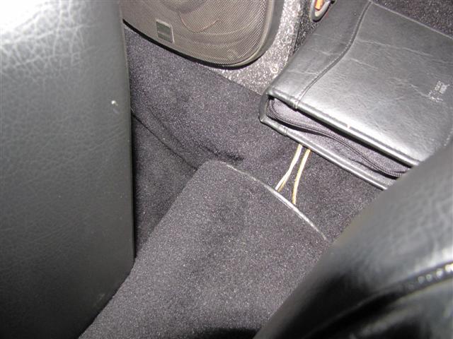

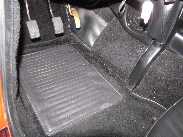

Jim have a look at British Parts Northwest(BCF sponsor)I have their carpet set in my TR6 since 1990. Still looks good with many miles on them(8500O). Fit was good,backing pad sewn on as well as heel and toe pads.all edges sewn.They still show them at $238.26 on their site.a couple of pics

No glue is used on the underlay I received from Rimmer. All fit great including the carpet and trim pieces. Not cheap. I also had fun installing custom snaps. I'd recommend never using glue except in the trim pieces.
