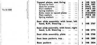

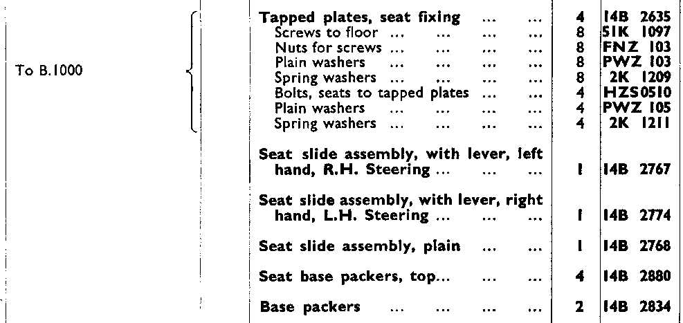

zblu
pan,
your quite right, just looked in the parts book and there they are, just that mine came sans slides, have them in now, but am thinking of removing same so as to lower self further into cockpit to enable better vision thru the windscreen, not the top rail on the windscreen!
pan
zblu,
Even without the seat sliders, the seat would be at the same height, wouldn't it?
I would have thought the wooden packer to be similar in height to the slider.
