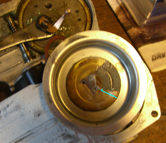

This probably falls into “do or die surgery”, but I’ll throw it out there anyway. If the motor spins past the park zone, maybe cutting some of the copper contact off to widen the park area would do the trick.
I suspect this photo is of the earlier motor - can the OP confirm this?
I've just fitted an MG 2 speed motor, and so far haven't worked out how to make it park.
The park switch is in the bottom of the body, and won't be as easy to adjust as the old type.
