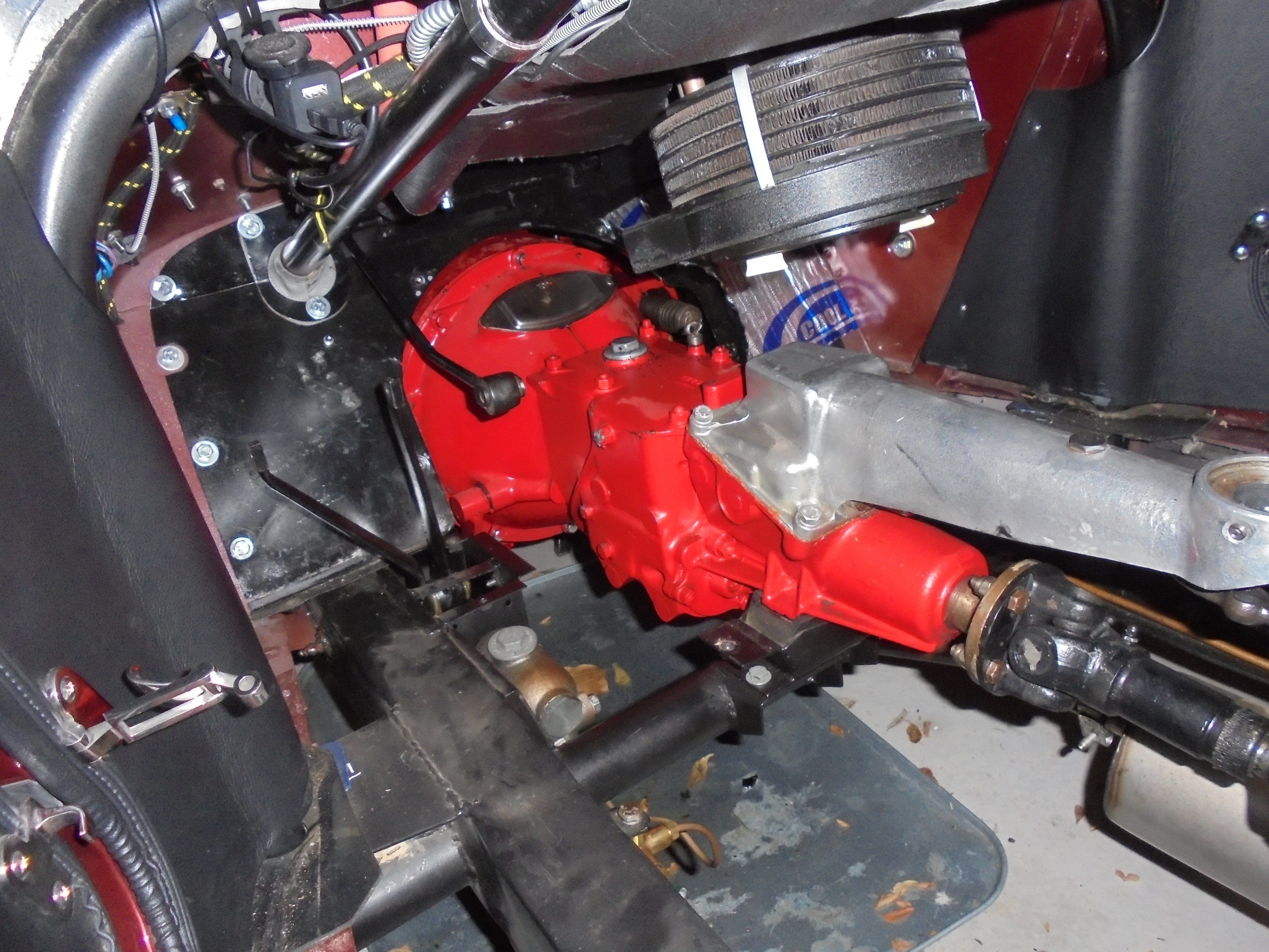

From all reports, it shouldn't be too hard to pull the transmission out, to replace it with the 5 speed. It's just a pain as it has to come out from the inside, cross-member won't allow it to be removed from the bottom. Once out in the open, I'll use an engine lift to pick it out. The Smith heater hopefully isn't in the way as the top of the remote is fairly close, if needed I'll have to remove the remote first.
Because I don't trust the bell housing to sump threads, (they're not as snug as they should be) and 33 foot-pounds torque might be a little too much, I'm installing 8mmX1mm Heili coils in the aluminum sump.

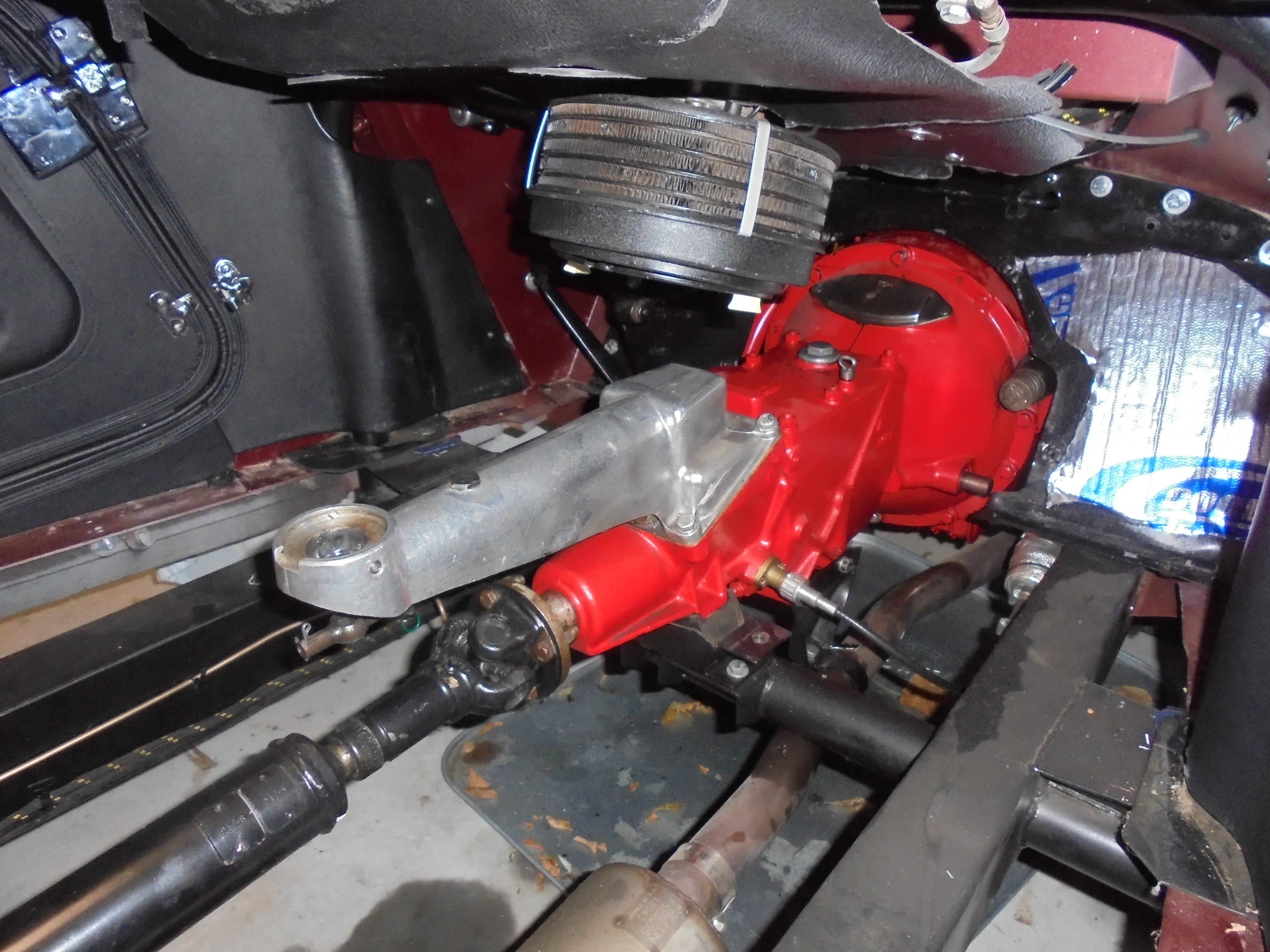

I received this from High Gear for the type 2 kit. Type 2 kit doesn't require moving the engine, but does require cutting the rear mount cross bar. and incerting a custom made casting rear transmission mount.

Forgot to mention, With the newer Type 2 kit, the original trans cover is used.

The transmission has to come out the top Tom, the crossbar won't let it come out the bottom. Engine hoist to lift it out making sure it doesn't touch anything. I really like the fact that the original cover is used as nothing is changed above the floor. All original equipment will be crated, kept together and stored, for now, I'll decide later what to do with it if anything. PJ
