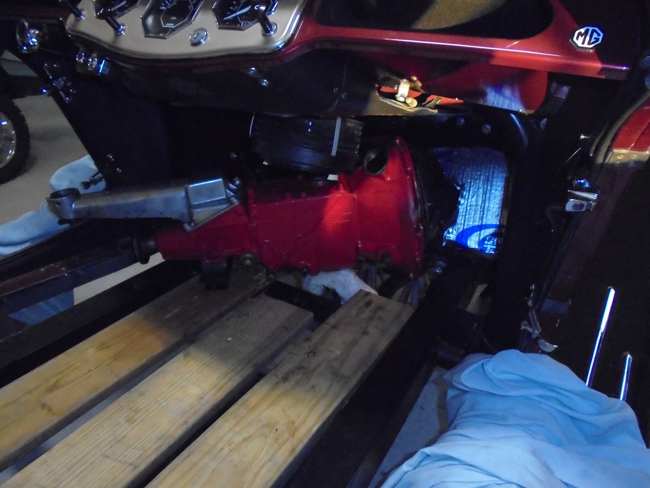

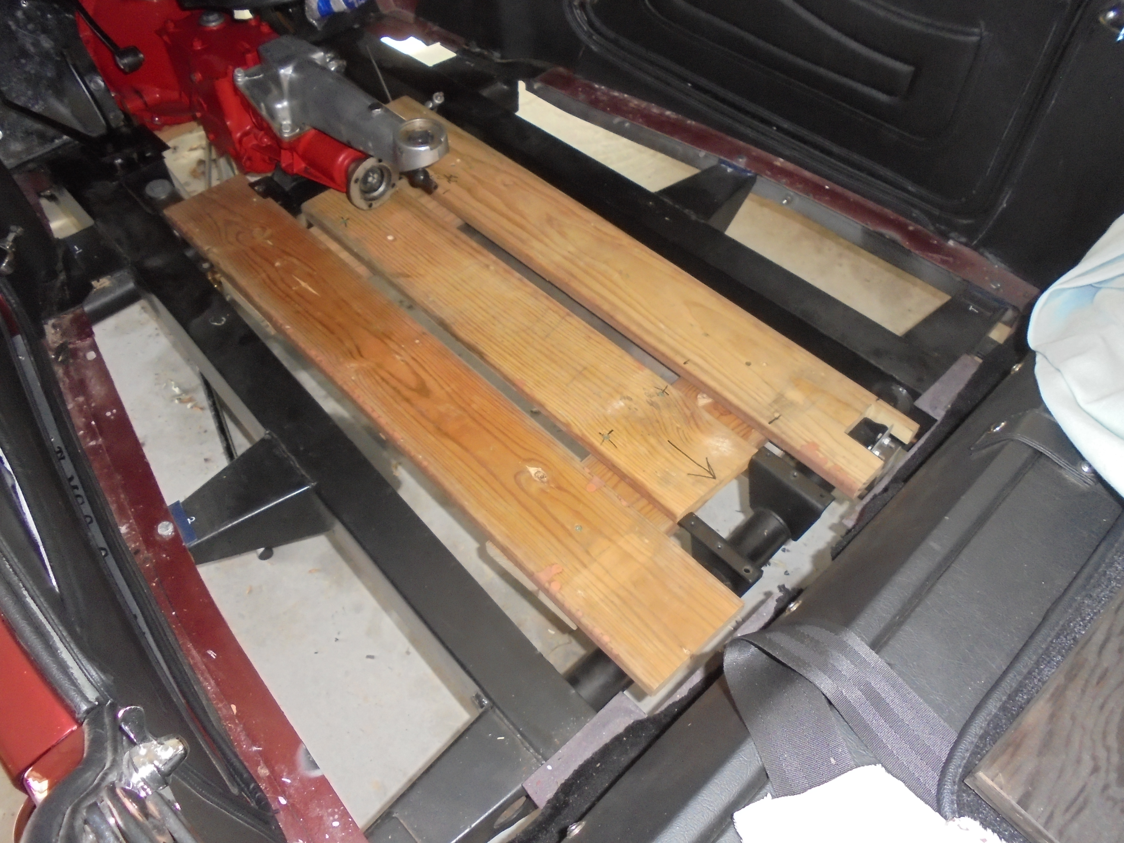

Here I'm getting ready to pull the transmission, I need it out to repair the Aluminum sump threads. Had to make a temp floor to rest it on after pulling it out. I need a wide floor base as the heater is in the way of the bell housing and need to turn the tranny hopefully to get it to pass. I don't want to pull the heater out!! Will show progress, if there is any!?!? PJ

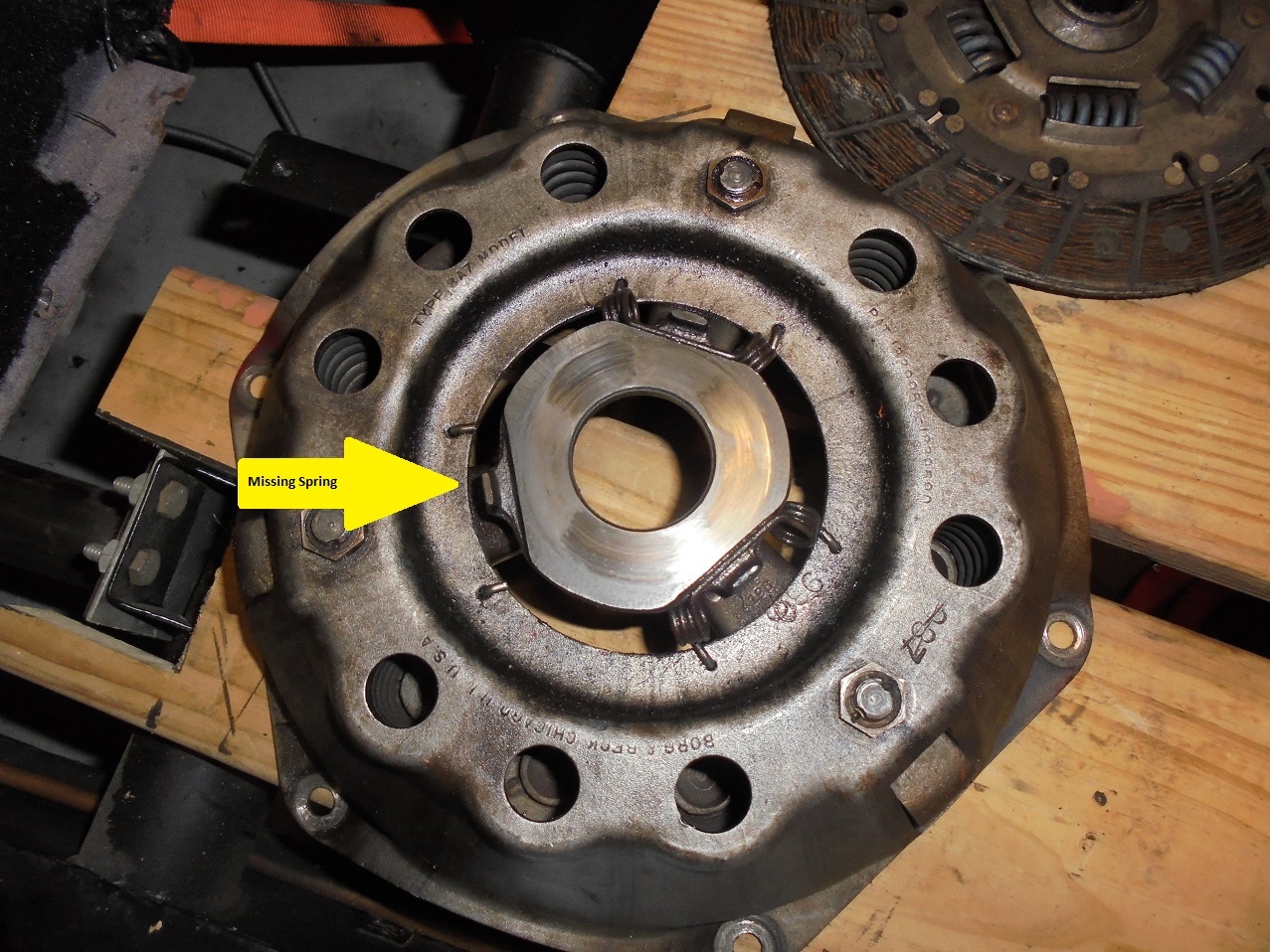

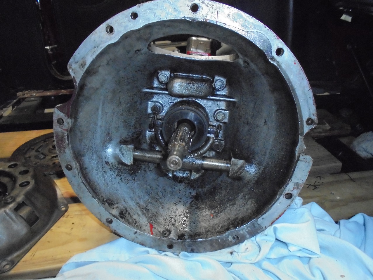

I was going to do that Doc, but I decided to pull the unit with the pressure plate and disc attached. Working through the inspection hole with an 18" 3/8 extension and a short socket was a little much, but it worked. Transmission is out. Found out it wasn't rusted, it was a return spring on the pressure plate that broke, fell down, and jammed between the spline and plate. Borg & Beck pressure plate also! Here are a couple of pics. Kinda tough taking everything out through the top under the dash laying half on your stomach and being careful not to touch any painted surfaces! I do not want to do this job again, if needed I'll sell the car! :devilgrin: PJ

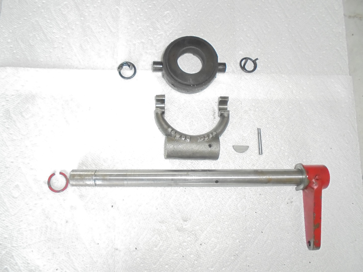

Pulled the clutch shaft to transfer to the new bell housing, new 3/4 inch forks are NA! Seems to be what most guys do. The parts came out in like new condition. At least something is in my favor!
