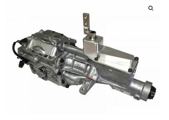

Driven has engineered a new tail section for the Tremec T-5 transmission and it places the shift lever exactly where it should be for the Healey center shift location. Everything is supposed to be bolt-on without modifications to the car.
The Tremec uses an adaptor plate to bolt to your original bellhousing and 5th gear ratios can be ordered at 0.71 and 0.63 depending on your differential gearing. I believe with the 3.54 ratio, RPM at 71 MPH is either 2350 or 2000 with the two options.
Hopefully, someone has installed the kit behind a stock Healey engine and has additional feedback.
Regards, Bill

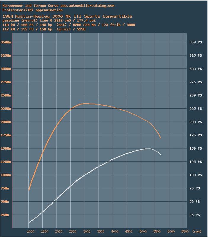

The TKX is 25 pounds heavier than the T-5 at 100 pounds and is rated at 600 pounds-feet torque at 8000 RPM. The lighter T-5 is only 75 pounds and rated at 330 pounds-feet torque at 7000 RPM.
Unfortunately, our BJ8 only makes about 150 HP and has at most 170 pounds-feet of torque. So, the T-5 transmission is more than adequate for our driving needs. All the feedback I have seen for the latest T-5 Cobra transmission says it is a very durable, dependable and easy shifting transmission that is still being manufactured and updated today after 40 years of production (with lots of tail housing and shifter options available). Parts for the T-5 will be available for decades. I really don't think we would be gaining much using the more expensive and heavier TKO transmission for our application?
We usually do not power shift our stock BJ8 transmission much beyound 6000 RPM when driving on the street. From an engine torque standpoint, there is very little to gain by shifting the BJ8 after 3500 RPM. The T-5 rating of 330 pounds-feet torque at 7000 RPM should be OK.
I am looking for a bolt-on 5-speed kit using a good (new) transmission with a 0.63 or 0.73 overdrive 5th gear that will be easier for my wife to shift (the T-5 has carbon fiber lined steel synchro rings for improved friction surfaces and shifting). The Driven T-5 kit appears to meet my all of my needs and I was asking for feedback from someone who has installed the kit.
Thank you.
Regards, Bill

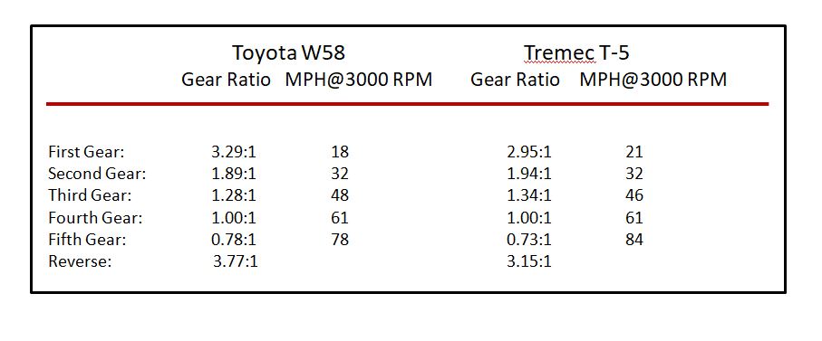

WHT
WHT
Hi Michael and Rob,
Thank you for the information on contacting Pete Delaney. As mentioned, when we began looking for a 5-speed conversion for a BJ8 this was our first plan. The W58 weighs about the same as the T-5 and it is a good side-loader transmission. But, Pete's contact information is difficult to find.
I will contact Pete if possible and see if they still sell the Delaney-Smitty kit just to touch all bases. However, I read accounts from more than one person that it could take weeks for him to respond to a purchase request or installation problem sometimes; and that kind of turned me off on the Toyota conversion. I also saw that several people doing the Toyota conversion had problems with off-center machined parts (misaligned bell housings for example).
Driven Man has always gotten back to me in a few minutes with either kit information or specifications from their technical advisor. It is a much larger company and all of their machining uses modern CNC technology. The only real downside appears to be the cost. But hey, life is short. We can either spend our money now and enjoy it, or let the current government take it. :smile:

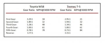

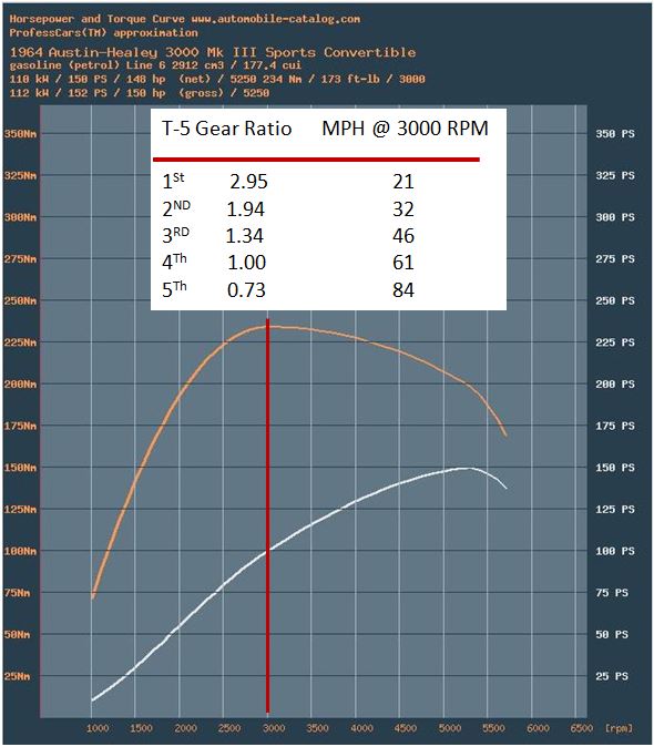

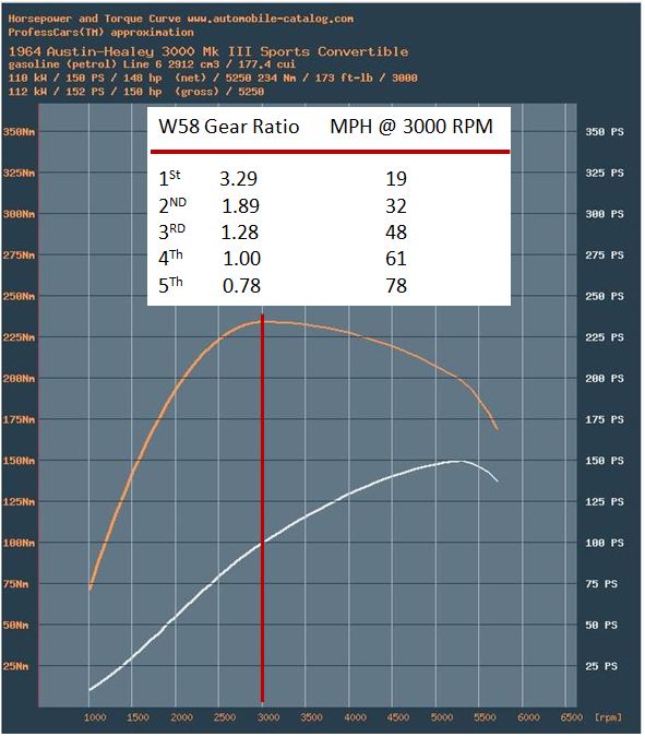

Also, as mentioned previously, Driven can provide either 0.73 or 0.63 5th gear ratios. I looked at their gear ratios and they seem to fit the Austin-Healey engine HP and torque curves and our driving needs reasonably well. Please see my included torque curve and speed calculations at 3000 RPM for both transmissions. Both transmission gear ratios are similar, but I like the T-5 spacing better.
Thanks again.
Regards, Bill
