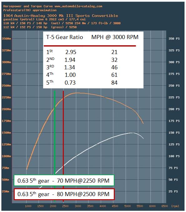

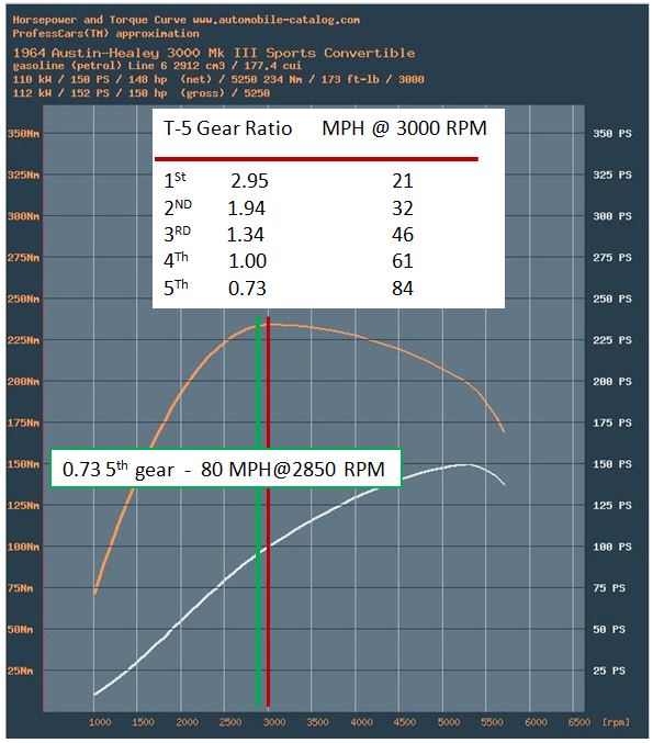

Hi Bob,
Well, I am open to recommendations (but, about to order).
We have a MGTD and you don't want to lug the engine at 2500 RPM.
My though was 4th gear provides 51 MPH at 2500 RPM and 61 MPH at 3000 RPM
I was going to order the 0.73 5th gear with our 3.91:1 differential and that yields 70 MPH at 2500 RPM and 84 MPH at 3000 RPM.
The 0.63 5th gear yields 81 MPH at 2500 RPM and 97 MPH at 3000 RPM. That seems like a very large gap between 4th gear and 5th gear?
I doubt we cruise faster than 80 MPH (2850 RPM with 0.73 gearing) and we would still have good acceleration without down shifting if needed in an emergency; looking at the torque band.
Is this bad thinking?
Regards, Bill

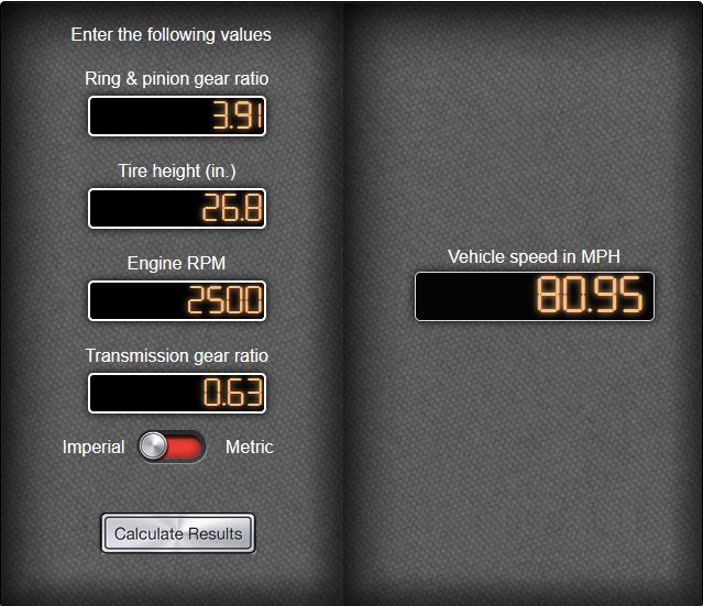

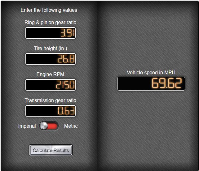

OPTION 1: As posted several times, the 0.63 5th gear with 3.91 differential gearing would cruise at 70 MPH at 2150 RPM, 81 MPH at 2500 RPM and 97 MPH at 3000 RPM according to the Spicer speed calculator. These are also the same numbers Driven gave me independently. So, they are either correct or we are both wrong.
This combination would force us to run the engine at 2150 RPM to cruise at 70 MPH in 5th gear; or we could run the engine at 3450 RPM in 4th gear. Running at 2150 RPM drops the engine out of its torque band and would not be beneficial to the engine in my opinion for long periods of time. Saving gasoline is not that important.
OPTION 2: The 0.73 5th gear along with our 3.91:1 differential gearing would allow us to cruise at 70 MPH at 2500 RPM and 80 MPH at 2850 RPM which is better IMO (plus it keeps the engine in a stronger torque band). And, we can still top 100 MPH when racing SRT Demons.
Again, if my numbers are correct, am I missing something? I am more than willing to accept my calculations are bad and should be corrected; and would appreciate your knowledge and help with this.
Please see the included speed calculations and torque band chart.
Thank you.
Regards, Bill

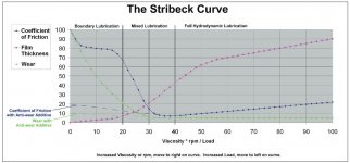

"I've never thought of Healeys as being high revvers, and there appears to be a consensus that Healey 100 engines can become very unhappy over 4,500RPM"
Your car runs 72 MPH at 2500 RPM with your gearing (3.54 rear end, W58 trans with 0.78 5th gear). So, this should not be a major problem for you.
The problem is, YOU are telling me to order a gearing combination for my car that will cause my engine to turn 2200 RPM at the same cruising speed. Then you become flippant when I simply asked you why that was a good idea.
Thanks, thats really great advice! Silly me, those are ideal conditions for an engine designed in the 1950s to ensure perfect oil pressure, lubrication, hydrodynamic oil wedge formation,coolant flow, cooling and reduced friction (NOT). My crankshaft and bearings will thank you.
BTW, your engine becomes sad over 4500 RPM because there are large, destructive third order harmonics as it nears 5000 RPM.
Regards, Bill
Regards, Bill

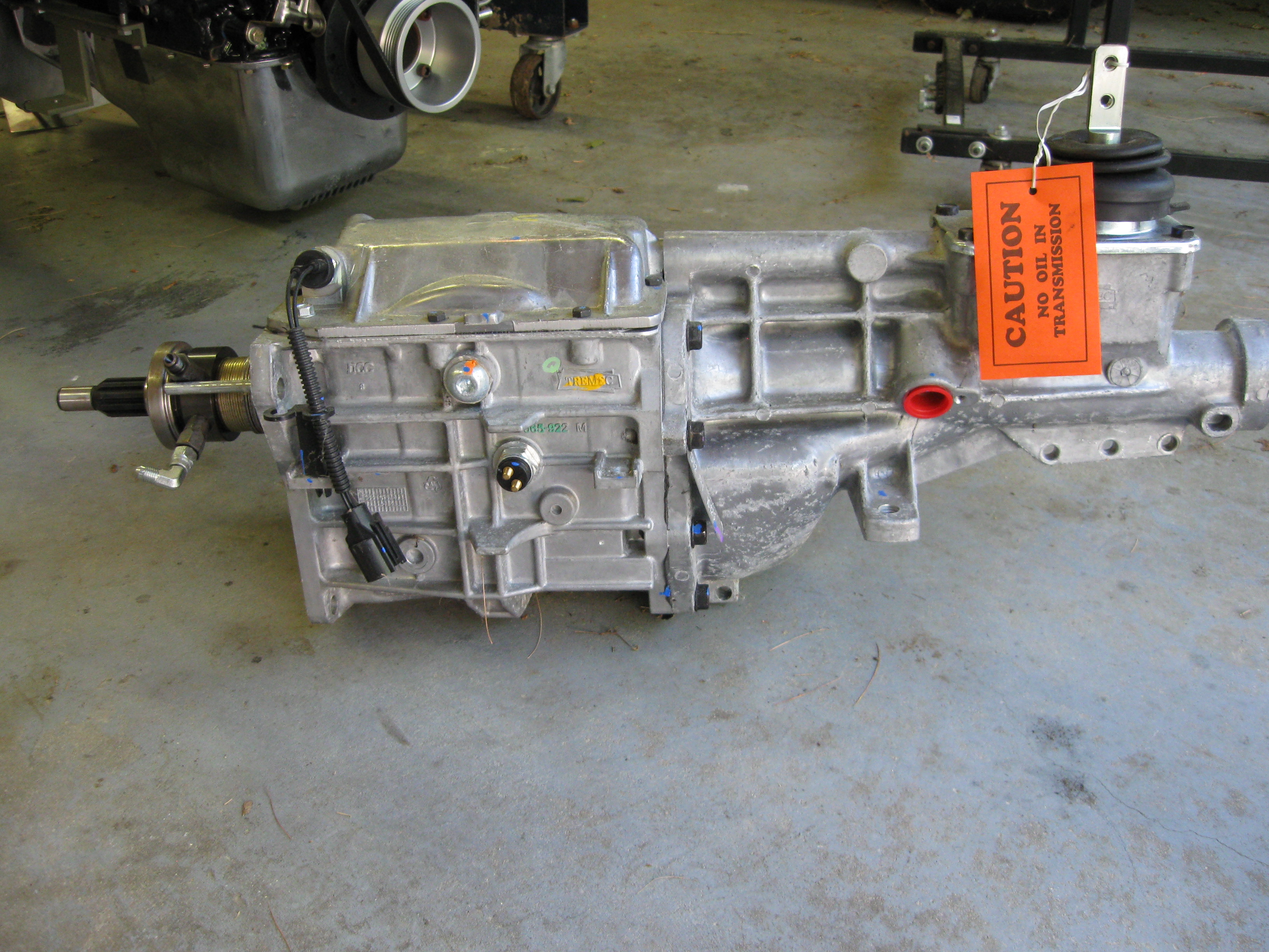

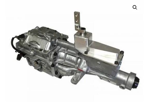

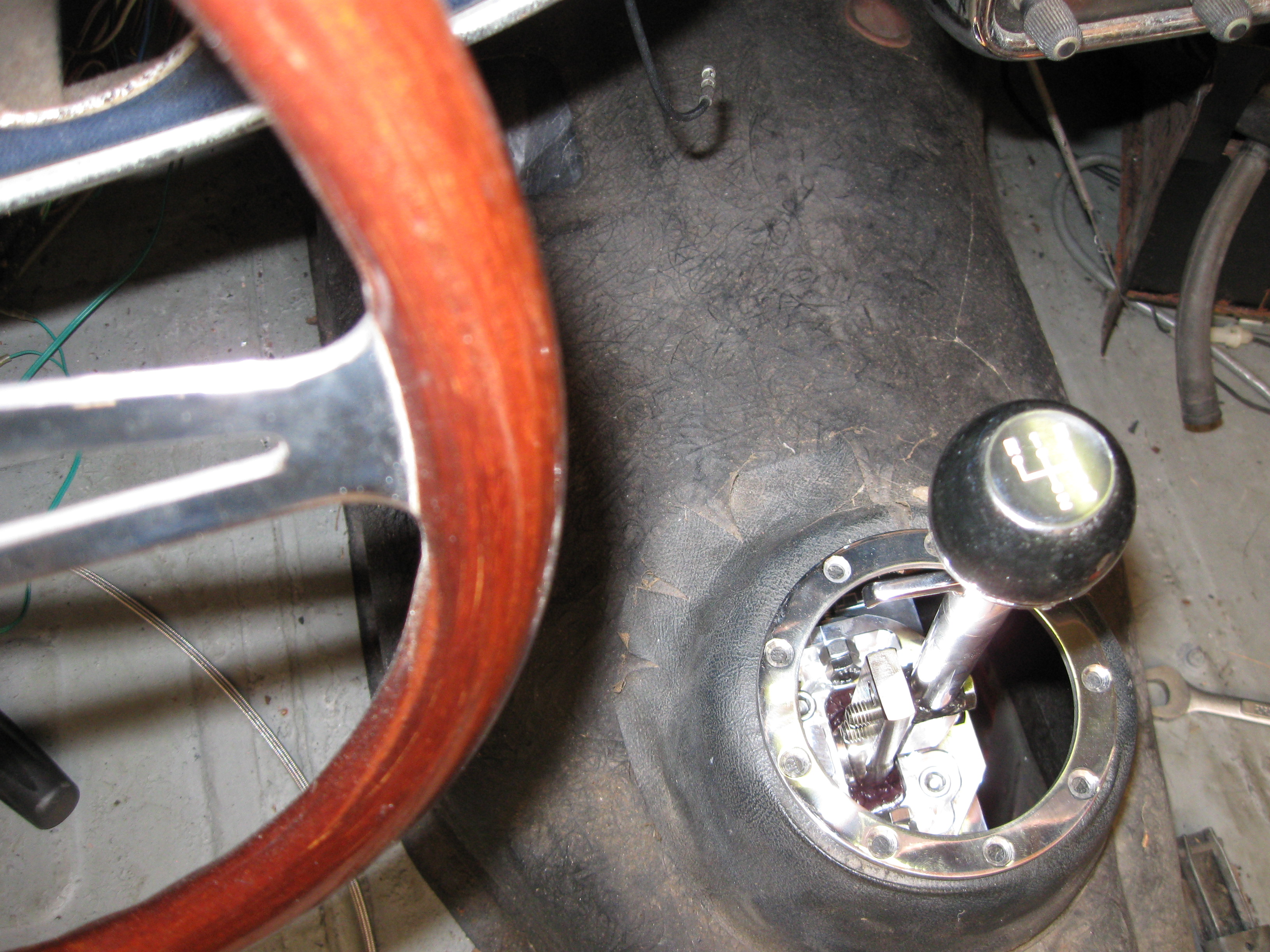

Just something else to drive you crazy about the shifting action.
Here's my T5Z:
When I installed it I was able to center the shift directly below the hole in the tunnel and use an optional Mustang shifter (this is because I was positioning the engine/trnasmission combo so that it would work out this way and adjusted the motor mounts and engine position to suit:
Now note what Driven Man has done to get the same result, they have engineered an entirely different shifter mechanism, which looks like there may be an internal linkage between the shifter extending back to the shift tower itself. This would make shifter feel unique to that conversion. As you've said, "Ask the man that owns one".
