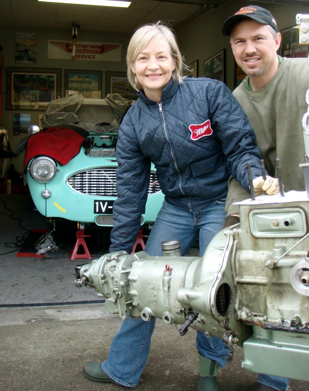

bob hughes
Me
I manufactured some brackets with tubing attached, to bolt onto the engine mounting locations (like an old cannon with trunnions) and then made up a stand of two vertical posts on wheels with Vee tops so that the engine could 'balance ' on the top and could be rotated. It did need a few holes drilling to lock off the engine in the various positions using a surplus screwdriver as the pin.
