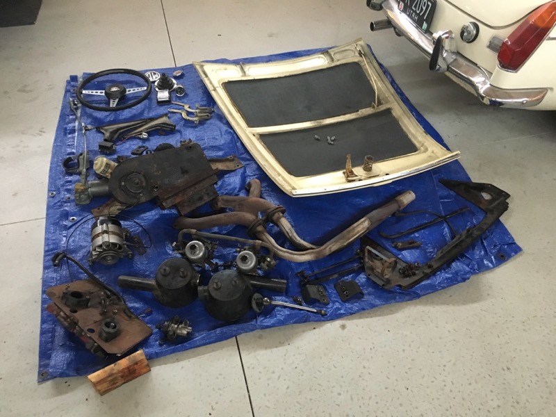

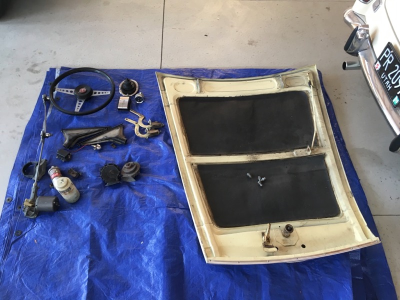

This visit got me motivated, and I started pulling parts I wanted. Main was the aluminum bonnet (my car does have one as well), a nice spare to have on hand. Otherwise I'm just pulling a few bits and pieces that might prove useful down the road.

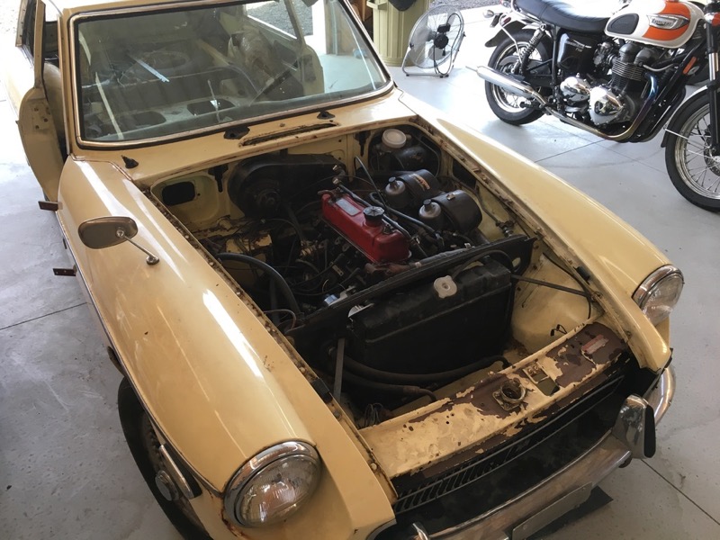

I've not pulled an MGB engine before. Anything I need to be thinking of, dealing with?

Pretty straightforward - pull engine and transmission together after removing the radiator, both manifolds, starter, alternator, and distributor. Oh, and the shift lever as well. The nuts on the motor mounts can be a little tricky to access, but otherwise it's not a big deal. There's plenty of clearance to yank the whole assembly.

I use an HF engine hoist and it can be difficult to get close enough to the front of the car to fully reach the center of the engine and the tires can get in the way as well. I ended up with the car on jackstands with the front ones as far back as I could get them without upsetting the balance and the a$$ end of the car elevated. Other than that it’s just disconnect all the lines, mounts, shift lever, etc. and jack that sucker up and out. Make sure the lift is on a smooth surface or it can be difficult to roll once loaded.

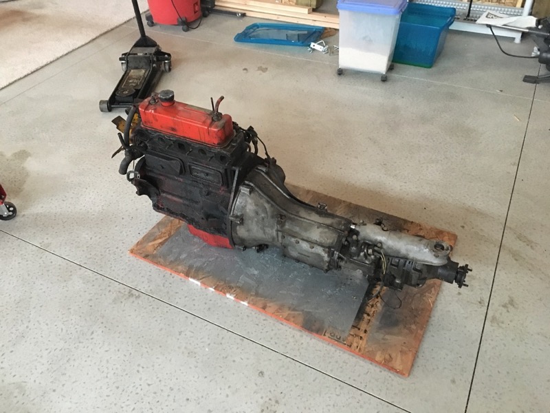

Got everything pulled today. Thanks for all the tips, they helped. In the end the only thing that held me up was forgetting to pull the shift lever out before I started to try and pull the engine. Was wondering what could possibly be holding things up... :grin::crazy:
So the plan now is to separate the engine and transmission and throw in a new clutch. I know my old trans (also OD) is good I will likely reuse mine for now. This one will get rebuilt at some point for a spare. Will probably reuse my carbs and distributor as well, as they've both been rebuilt in the last few years.
I grabbed a few things off the car that I could use as spares for mine, including the aluminum bonnet, wiper motor and boxes, heater box, and a few other random bits. The shell now goes to a friend who will strip the rest of the car down for what he wants for spares. I'm trying to only grab what I can use on my car, as I don't need to be a packrat with things that don't fit my stuff -- I've got enough junk as it is.
