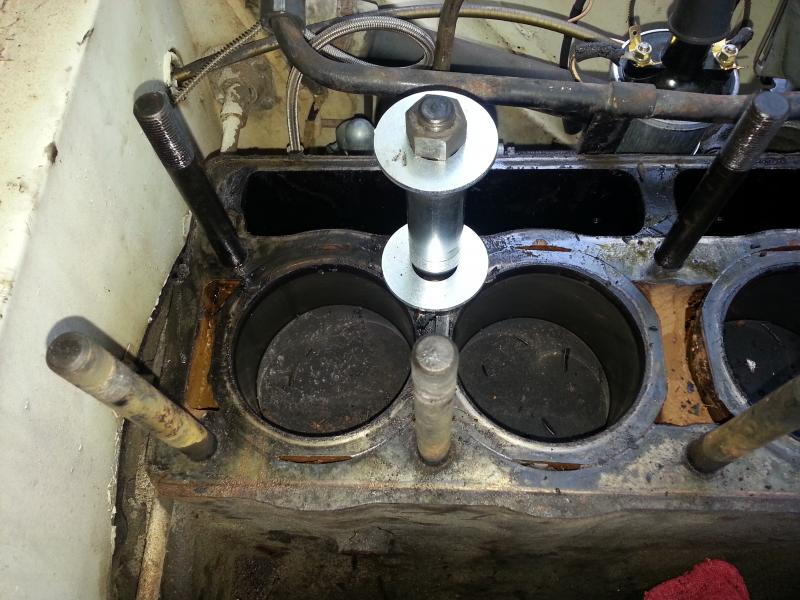

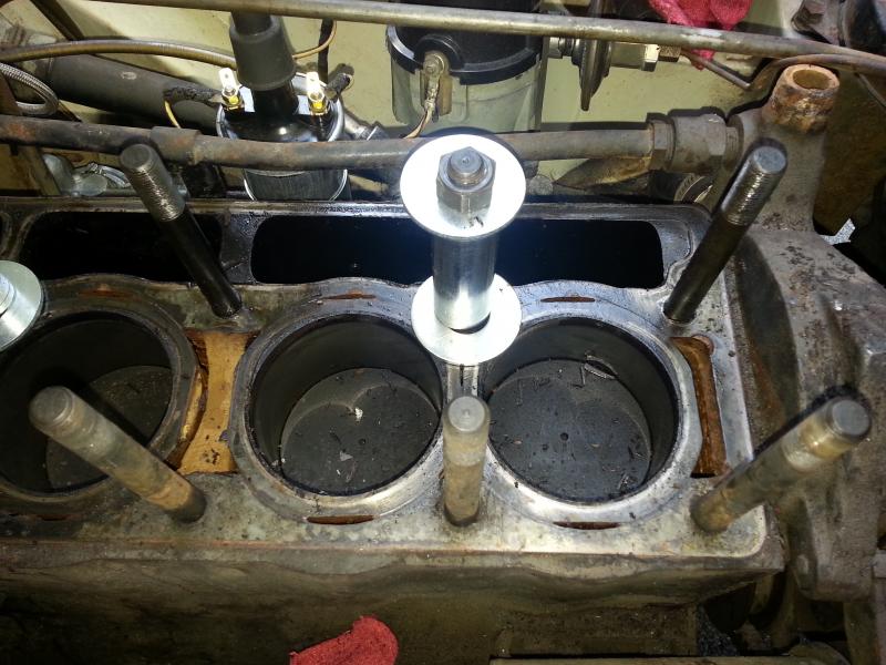

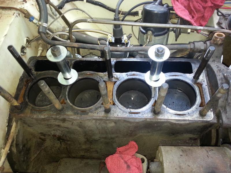

OK, head is off. It came off kicking and screaming, but it's out now. Pics coming tomorrow.
To keep the liners clamped, I was thinking using the block studs with pipe as a spacer and then large washers covering the ends of the sleeves?
Cheers, Dave

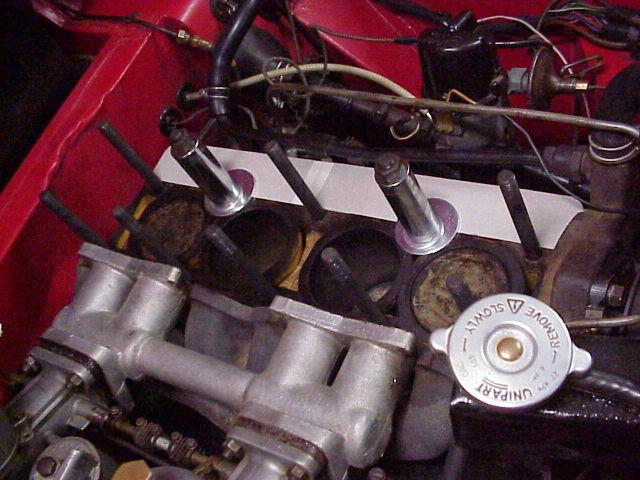

Should work fine. I normally drop a couple of big sockets over the stud.
Typical set-up using sockets:
I put a couple of pieces of cereal box cardboard over the wells for the pushrods/cam. I am just the sort to drop something in there.
Thanks all. I hadn't thought of my long sockets - just the thing! I'll put them on after the big rainstorm blows thru tomorrow - the vehicle is quite immobilized so I don't have to worry about the engine being touched in any way. Plus the old head gasket is still on, I will pry it off then. Looks like a copper one.

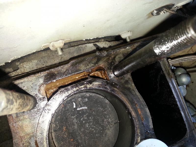

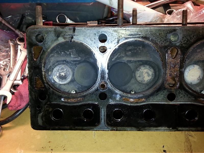

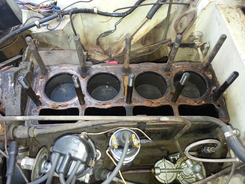

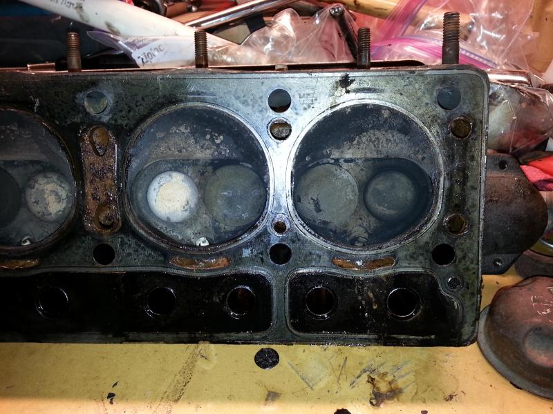

So here are the pics. It can be seen that the solidified crud in the head behind #4 comes up to about 3/4" below the block surface. Lots of work ahead. The head doesn't look too bad, but my thought is new springs, maybe new valves? Should I have my machinist harden the seats, if not done already? Also, something about not hot tanking the head due to aluminum pushrod guides? I will check tomorrow on pushrod diam and valve stem diam, hopefully get parts ordered tmw.
20170731_174320.jpg20170731_174325.jpg20170731_174332.jpg20170731_174338.jpg20170727_191528.jpg20170727_191533.jpg20170731_165024.jpg
I'd take at least a few valves out, at least one intake and one exhaust (probably #4 since it tends to run hottest) and have a look at the faces. It's hard to tell anything just looking at the top of the head (unless it's really badly burned, which yours don't seem to be). Also hold the valve with the head just 1/4" or so off the seat and try to move the head sideways. Any significant movement indicates the guide and/or stem is worn.
If all seems fine, put it back together. Your valve springs have been working, so I'd leave them alone rather than risk getting new ones that aren't as good.
But more likely, you'll find the exhaust seats at least somewhat burned, in which case I'd replace them. Valves can be refaced several times, but eventually need replacement. And if you're going to change them anyway, I suggest considering the later valves with 5/16 stems (plus the conversion guides of course). In my limited experience, they last longer and flow better.
