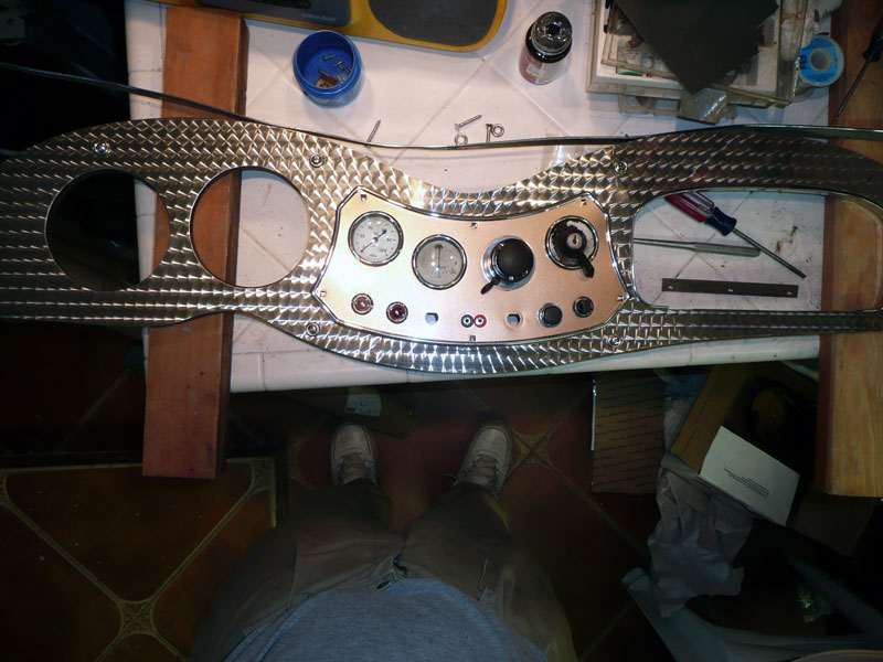

Wow! That is a beautiful bit of work on the dash panel. My old sports/racer is a bit rude and crude, which fits my skill level, nothing like a close contemporary Lotus 9. Thank you for your help with the switches. I found one at Speedway that will work for starting. I will probably incorporate the TD key/lever switch into the dash. https://www.speedwaymotors.com/Spee...46894473&utm_content=All Products (Jan25_2019)

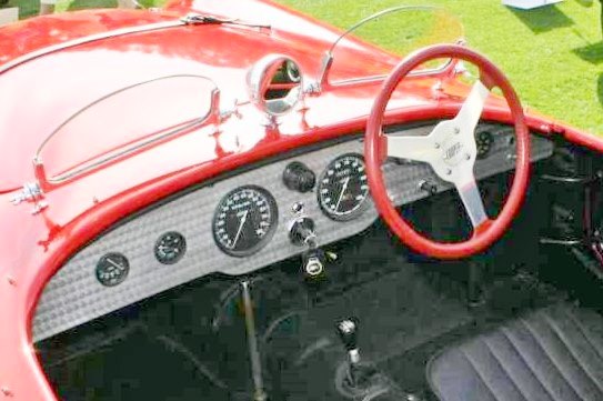

Nother question Jim. I was doing some research the other day about my Cooper based special and noticed the engine turned dash in the famous Cooper-MG Joy500. I remembered the beautiful dash you had built for your TD. Did you make the engine turned material or did you buy it ready made and cut it to shape. The shape of the cowl and dash in my car is very similar to the Cooper-MG, I really like this look, note the TD like switches.

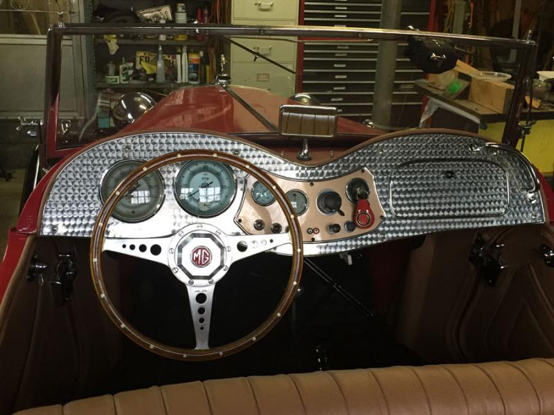

Mine are Stainless Steel
Moss used to sell them in the Mid 1960's. I have a catalog from 1966 wit the dash and other covers listed.
I found mine on eBay about 6 years ago. There were two at the time. I have not seen another sense.

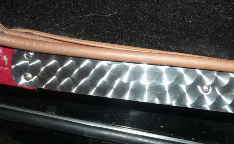

I was also lucky enough to fine matching door sills.

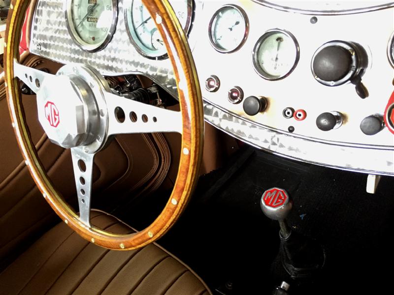

I felt that the original steering wheel hub needed more bling, so I made one out of an Aluminum block. The MG logo is the center of a wheel cover.
I then felt that the gearshift needed work.
Moss used to sell similar knobs.
Yes there may be too much bling.
