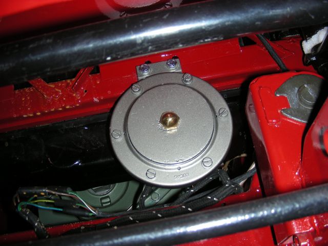

Does any have a photos of a set of Lucas horns for a 100 that have been restored to the correct color and everything that they can post or e-mail me? Thanks d-valentino@msn.com

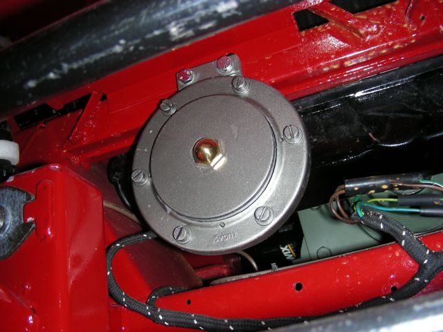

Healeysince59
These are the horns that I restored for my BN1. There was a little of what I assume was the original paint left. I found a very good match at Ace hardware called "Stainless Steel". I can't find the rattle can in my "organized" garage right now but it was probably Rustoleum or Krylon. I'll keep looking.
I know the brass acorn nuts should be painted but they looked too cool to paint. Remember, on a 100 you will be the last person to see those horns when you install them.
That's my problem, I will know and it would bother me if they are not correct. What I did find is paint that I believe is a perfect match to the original color, it's Dupli-Color #DSGM457 Light Driftwood metallic. I found out some things while taking apart five horns. While the brass nut looks cool unpainted we know that it should be painted, but the rest of the nuts were left steel. I found no paint on them and they were all rusted, even on the backside of the bolt. Now if they were painted, there would have been no rust on the backside of the bolt and there would have been some type of evidence of paint. With the way the bolts corroded leads me to believe they were left steel and the two metals do not react well to each other causing them to almost fuse together.
