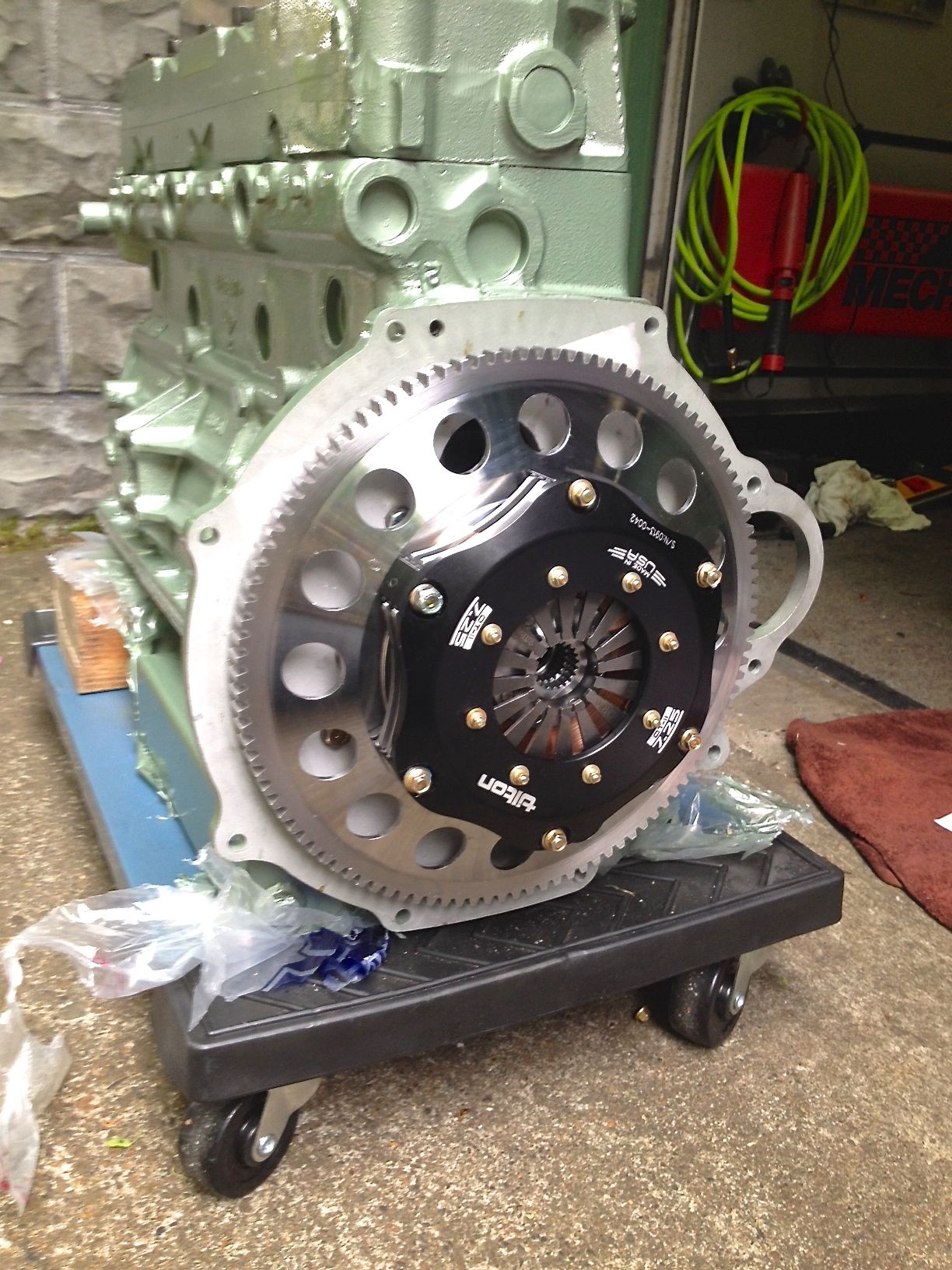

I use a Tilton 7.5" twin plate unit which might be a little too much for a street driver.....
