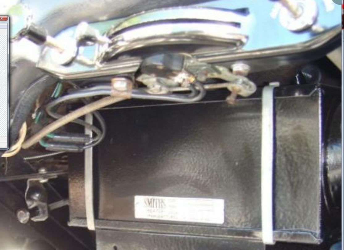

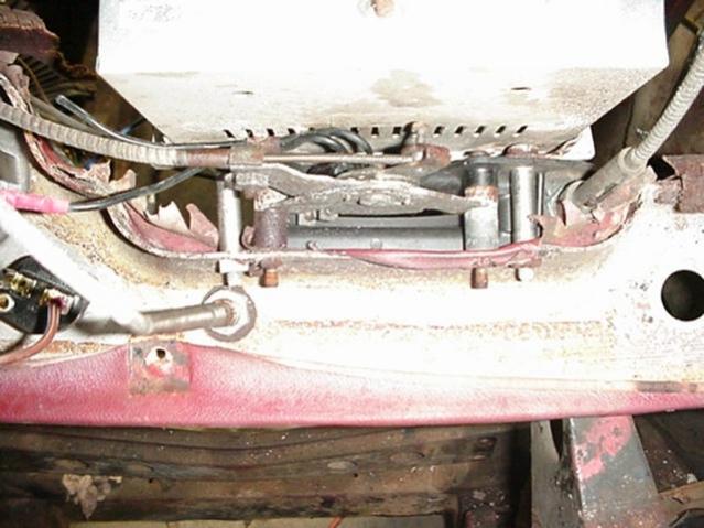

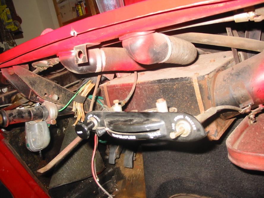

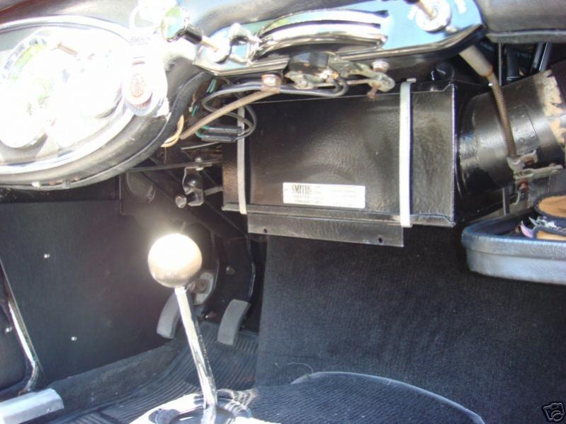

Or a description. One of the cables going from the heater controls goes to the flap on the side of the heater. I'm missing whatever attaches the cable to the flap part. I see how the inner cable attaches with a trunnion, but I don't see how the outer sleeve of the cable is held to the fixed bracket on the flap housing. I was thinking some kind of "P" clip, but there doesn't seem to be a way to position it to have the outer sleeve line up with inner portion on it's way to the trunnion. This is hard to describe!

Hi Paul
Hard to understand-- but I hope that ONE of photos help you
Cheers
V

Thank you Andrea. Hmm, yes I can see the cable connection on the right of that last photo. I was thinking it was something like that, but couldn't get it to work correctly. I can see now that the fixed braket on the heater box tube is really bent on this car, and that's why I couldn't get it to line up correctly. I think I can bend it back. Photos help SOOO much! Thanks you again.
