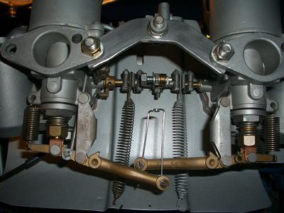

I am unsure how to 1) hook up the stirrup to the jet lever assembly, 2)hook up the two throttle springs, and 3)how the choke cable bracket hooks up. I have included a pic of how I think they go together. Can someone tell me if this is correct? If there is anything wrong, can someone tell me how to correct it? Thanks for your help.

You got it, well done.

I had a setup of H1's on my 948 but swapped them for a nice set of HS2's. From my experiences your setup looks good.
Of course you need the choke cable to go through a mounting above the stirrup and have something on the end to come up against the 'hole' in the center so it will pull up. Then springs at the ends of the levers pull it back down.
