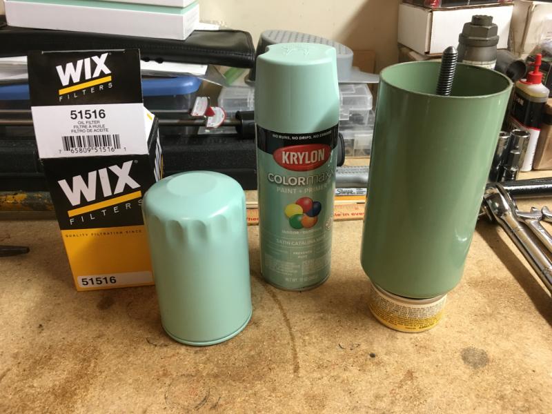

Follow up:As I mentioned earlier, I was able to get the old, hard gasket out and fit one from TRF. I then put the canister (with the filter inside) back on, but I had to tighten it up pretty good once it was filled with oil and under pressure with the engine running. I had a very tiny leak/drip at the end bolt, but figured that would go away or was from handling.
The drips continued and in about a week, I had leaked around a half-quart. Not good. I was afraid that I had tightened the canister too much and risked stretching the bolt. Tired of messing with it, I ordered a spin-on adapter and WIX 51516 filters. Today, I removed the original canister and carefully put the spin-on adapter with the correct torque. I put the threaded adapter on with blue Loctite and torqued it down, per the instructions. I spun on the new filter (painted a teal-green to mimic the original) and gave it one three-quarter turn by hand after it was seated. No drips, no runs, no errors. Success! Thanks to all for the advice and help.
