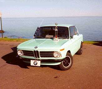

I know exactly how that feels! I worked two days straight without sleep finishing the paint on one of my BMW 2002's. I was preping it for a big out door show. I Just finished washing all the compound out of the jambs and under the hood.
All I had left was to pull it out of the shop, and catch a one hour nap in the office (5:00 am) to get to the 7:00 am check in.
I started the car with the hood open. The 2002 hood opens forward. Suddenly oil started shooting up out of the engine compartment all over the underside of the hood, on the roof, windsheild, cowl, all over the engine and up on the ceiling of the shop! DRAT!
I guess while I was wiping off the engine I cracked the copper oil pressure line. I didn't have a spare crush barrel fitting. At 5:00 am I wasn't gettin one at the local flaps either! So I carefully drilled the copper line out of one side of the barrel fitting and slid the line out then reused the fitting.
It only took about another 1 1/2 hours to pressure wash the oil off and get the car re-detailed. So much for sleep. It's over rated anyway!
The loss of sleep was worth it. I trophied over some serious big money cars!
