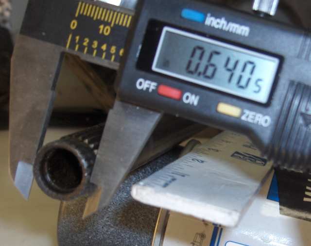

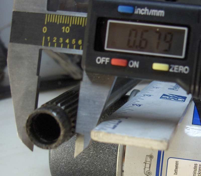

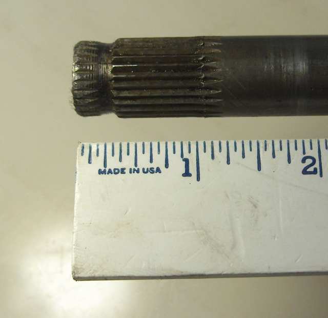

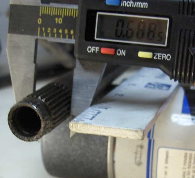

I was unable to get a good picture of the 'peen' on the end of the steering shaft. It is clear that the shaft has a splined end, that is tapered close to what the worm also has on the inside. Please look at the attached pictures. Only the last 1" or so is splined, and the shaft is smaller in diameter than the inside of the worm (where the non-splined worm end will fit). Only the splines hold the worm on the shaft. If you look, the first 1/4" is what is being 'peened' to hold the splines tight inside the worm. The bearing race and/or worm end are not peened, only the shaft. The shaft is not peened in a bunch of places, it is peened uniformly as with a tapered round drift that stretches out the last 1/4" to hold the worm tight to the spline. The shaft is also hard steel, but not as hard as the worm. It must take a lot of force to peen it -or a press of some sort. This is only my observation, and like anything related to safety, if you're not comfortable with these ideas, seek professional help. -and I don't mean that exactly the way it sounds.

Got_All_4
I'm going to agree with TexasKnucklehead. In machining classes we called that a sweat fit. As the worm gear cools down and shrinks onto the shaft the shaft heats ups and expands from the transfer of heat from the gear. It will produce such a tight fit it would be hard to press off. Also what else will happen is the hole in the worm gear will also expand and the gear will slid back farther onto the shaft getting the full advantage of the taper fit. Which is probably why when cold pressing it on it wants to walk back off. I would also have a pipe ready the same diameter as the shaft to give the gear a good whack after setting onto the shaft. Let it air cool or stick it into a bucket of sand to slow the cooling process down. The longer it cools the tighter the fit. After the sweat fit it should be tight enough to peen over the edges. What ever you do don't go over the 350 degrees. I seem to remember at 400 degrees the temper or hardness starts to change. You can do this in your oven at home. Just make sure your oven temperature is accurate.
Well, I can't prove it, but I doubt the factory bothered with a sweat fit here. The locking taper and peened end seem plenty adequate to me. After all, it's only the driver pushing/pulling on the steering wheel that tries to move the worm on the splines. The splines themselves take whatever force is needed to turn the car.
I believe the original setup was swaged in a press (using a die to spread the end of the shaft). My suggestion of peening in a bunch of places was intended as an alternate solution, when no press/die is available.
