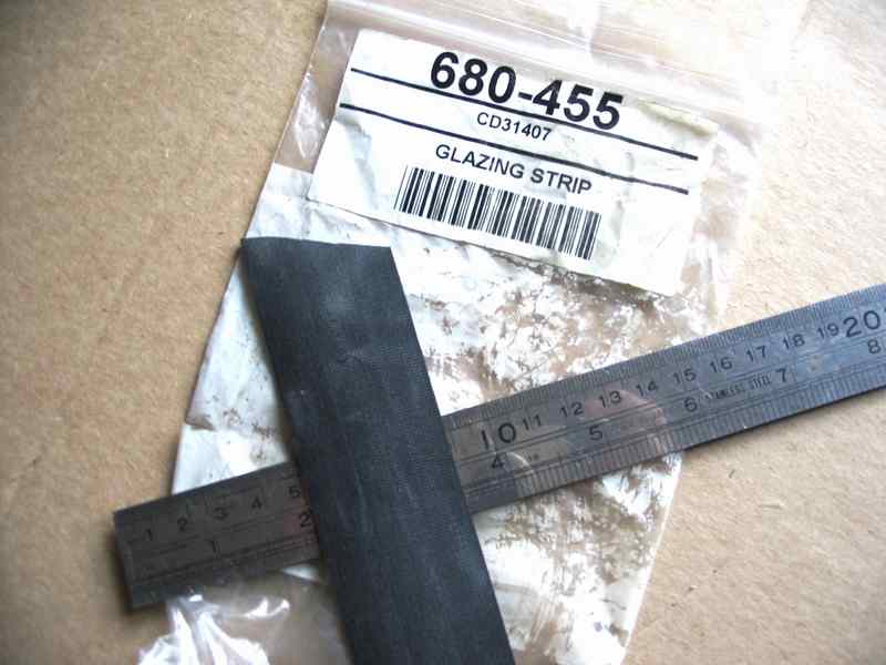

Don Elliott
It almost sounds like the glazing seal you used (too thick) has let all the glass go upwards into the top part of the frame, leaving insufficient glass to fit into the bottom part.
Here is the glazing seal from Moss that has the perfect thickness and width. After it's all together you take a sharp box cutter and trim off the excess rubber that you see protruding.
