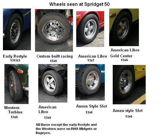

I've had 13X6 alloy wheels on my 73 RWA with 205s and they fit ok. There was a little tire rub on the rear at full suspension deflection, but for most driving it was fine. The wheel offset does make a lot of difference both in front and the rear. In the front the offset really comes into play when the steering is at or near full lock. Then you can get tire rub on the lower inside of the front fenders. I'd think that you should be fine with 6" wide wheels and no larger than a 185 tire. Check Tire Rack for tire options, Sumitomo makes a 185 60 13 that would probably fit fine. Other wheel options for RWA Midgets and Bugeyes are those from the 70s GM small cars such as the Vega and Monza. Here are some of the wheels available from the factory for those cars. Lug pattern is the same and offset is ok for a RWA car. You'll need special lug nuts though these wheels were designed to use a 7/16" stud instead of the 3/8" stud the Spridgets use. https://monza.homestead.com/wheels.html and some photos of different style wheels seen at last year's Spridget 50 party. The wheel labeled "Custom built" is very special, with a customs offset both front and rear to match the Bugeye they're installed on. (Spridgets have different width tracks front and rear so some offsets will work well on one end and not the other)
