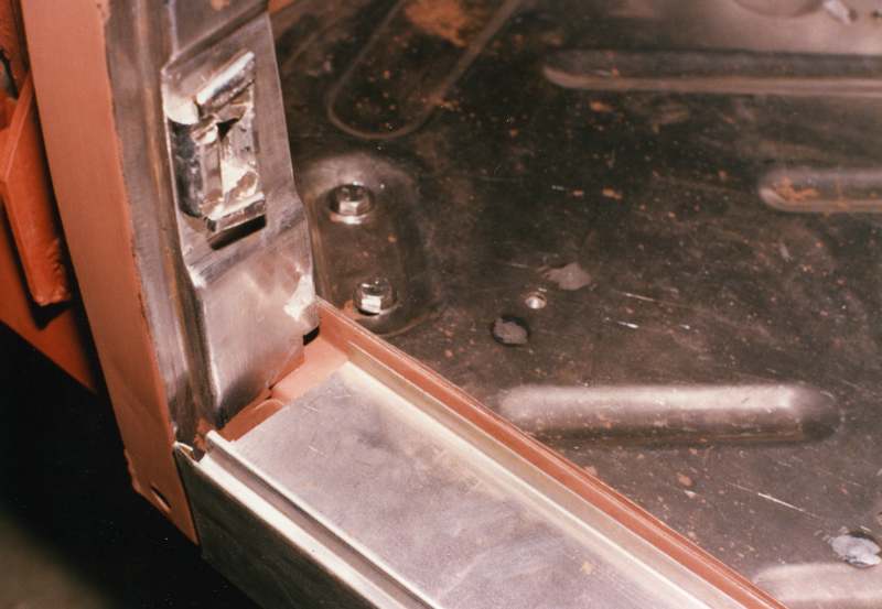

mrv8q
Keith, I'm not a body guy, perhaps these pix will help:

The original rocker panels had a slight contour curve to match the door. The new panels are flat. You can can build up the rocker to match the door. Some people do, some don't.

Thanks Kevin for the pictures they do help. Is that an original sill on the car?

You can use body filler. Fit the door so you can match the contour.

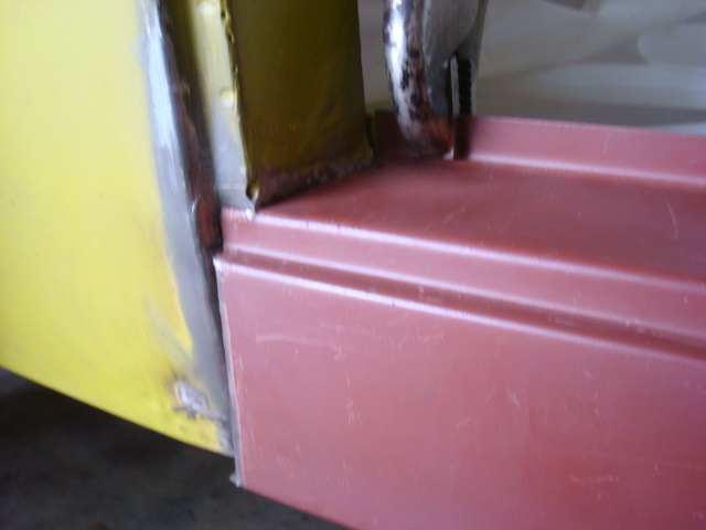

How do you seal the sill to the quarterpanel. The outer sill is welded top and bottom and the horizontal seam at the base of the jamb is welded to the top flat surfae of the sill. But the vertical portion of the sill has a small gap where it meets the quarter panel. Maybe shoot a little seam sealer there, to fill that small gap? Also, how do you seal the front part of the sill where it tucks under the front wing? Water could find its way in there too and pool at bottom of outer sill. I can follow up with some pics tonight if that would better illustrate my questions.

Good question Pat, I just made sure the replacement sill was clean and sprayed with metal etch primer, and paint in those areas. There are drain holes in the bottom of the sill that will help drain any water that enters. I think a small gap should be left to help draining.

The vertical gap at the rear end of the outer sill should have a small "V" indent to look original. The sills I bought in 1988 for my TR3A as well as the ones I bought for the later TR3A about 2003 were both short at the rear end and I had to add about 5/8" of new sheetmetal there with my MIG welder. A good seal-sealer will make it correct looking. I can't remember, but these vertical gaps may have been leaded to seal them. Body filler is also good, but flexing might crack the finish.
