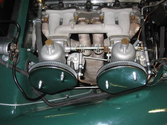

I put some thin air filters on a green TR3A we restored and which which had the TR4 long style intake manifold.
I have also seen where a TR3A owner took a 10 pound hammer and dented the inner fender outwards towards the wheel so his air filters would fit. It looked bashed really hard.
