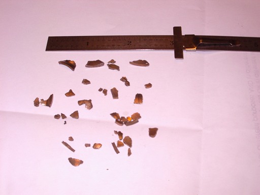

I have started tearing down my engine. I figure I can install new main and rod bearing, check rings and valve, timing sprockets and chain, oil pump, etc. and refresh the engine. Draining the oil pan revealed a trace of brass/bronze colored fillings. Dropping the oil pan I found several large bits of bronze colored non ferrous metal. I assume these are the remnant of a thrust washer, but any help identifying these bits would be appreciated. Here is photo of the bits.

I am afraid those bits are ground up a little too small for any ID other than "ick." If I found that in my sump, I'd be getting out the rest of my wrenches for more tear-down-and-look.
Thrust washers in TR3s are steel and babbit. No yellow metal in 'em.
Actually, I believe the originals did have a layer of copper between the babbit and steel.
But those fragments still don't look like crankshaft thrust washers to me. I'm wondering if perhaps they are from the brass bushing that carries the distributor and oil pump drive shaft in the block.

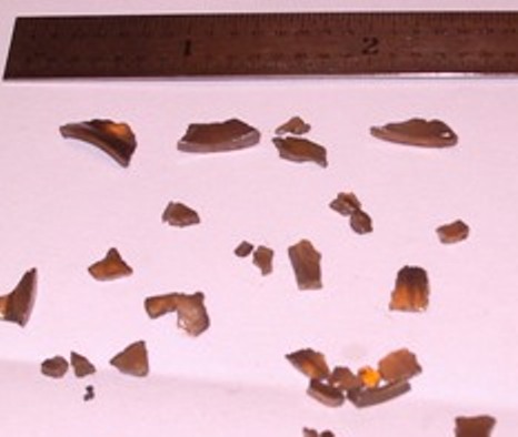

The piece do look like they had been round at one time, like a bushing. Perhaps you are correct Randall about it being a bushing for the oil pump and distributor shaft. Here is an enlargement of the pieces:

How about the gears for the gear drive on the distributor, color is good and if someone shoved it in there without shins they will knock for a while before this happens. ???

Re: TR3 Engine Noise Update
The gears are steel on a TR3. And if someone left out the shims in the distributor pedestal (and they were needed), then the brass bushing I mentioned would be the likely weak link (it's also the thrust surface for the driven gear on the oil pump/distributor shaft)

Aloha Randall,
I've driven this car about 50000 miles since 1999 when I bought it without any engine problems. Before I removed the engine the only apparent cause for concern was an unusual noise that was at first intermittent but over about a month became more constant. Oil pressure indicated at the gauge was normal for the car, about 50 PSI at speed and 30 PSI at idle. The distributor also seemed to be operating well and the engine idled smoothly at about 750 RPM. No doubt I will need to continue to dismantle the engine to find the source of these bits. I let everyone know what I find.

I agree with Moseso. A discovery like that warrants a complete teardown of the engine. I'd never sleep well until I discovered the source of the problem and whether there were similar problems developing.
well if the knocking was half the speed of the engine then its cam related since it turns half the rpm of the engine but appears a complete tear down and rebuild is in order, I think you would know if the thrust washers or washers were missing by removing the appropiate bearing cap, i assume you have the engine out of the car and easy access
