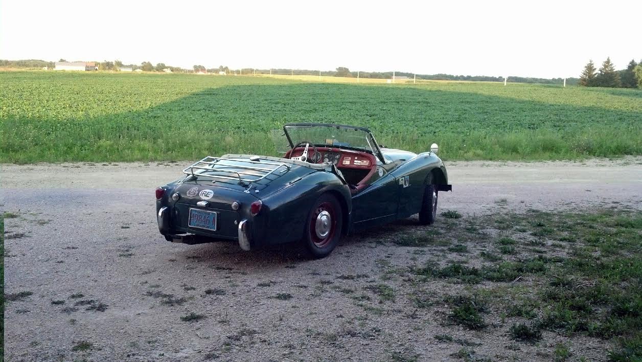

So, I drive the car the 20 minutes to my grandparents and they're not home... crap. It looked as though it was gonna rain and I didn't want to leave the car outside with no mention of what happened. So I put it in there garage and left a note about what happened. On the table and told them to call me when they get home. They don't take their cell phones with them anywhere. I feel like crap from breaking the car and not being able to tell them in person what happend but at this point it's almost 7pm and I haven't been home since I left for work. Grab my truck and go home.
They called me and seemed understanding. I have the windshield at my place(was running the brooklands, which is awesome by the way, first time I've done it) so I'm gonna run that over tomorrow and see what he wants to do with the car. tr3.jpg

Thanks!. It get a lot of looks and comments. My Grandpa "restored it" maybe 15 years ago.
Its looks good from 20ft away. any closer and any car person will start noticing things. I for one never knew there was metal trim that was supposed to be on the fenders, he has it bondoed smooth.
toysrrus
"Ouch" on the "Bondo" over where the "Chrome Beading" is supposed to be.
Are all 4 Fenders Bondoed over? Thats a project for another day.
Get the little devil running properly by buying a new Water Pump & Pulley & be done with it. As someone mentioned here; Its really an In-Expensive repair.
Nice looking TR by the way.
Regards, Russ
