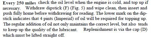

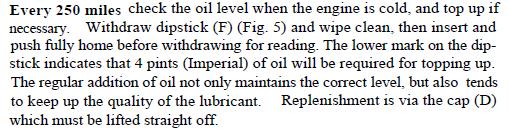

I read on another forum that the distance between the two marks on the dipstick represents 2 quarts. Is this correct? Also ,someone stated that if they just put enough oil in the crankcase so that the level was down 1/2 quart there was less problems with leaks? Any thoughts?
