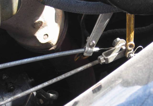

When I pull the choke knob all the way out on my TR-3 the front jet lever moves about 1/2 way to the choke cable support on the jet link. When the choke knob is pushed all the way in, the front jet lever is perfectly vertical which is how I believe it should be. I've seen photos on this forum of H6 carbs that when fully choked the jet lever nearly touches the choke cable support. Can anyone tell me if I need to pull more of the choke cable wire through the cable connector which would move the jet lever toward the cable support? I'm not sure that my car is getting fully choked right now, however, I don't want to be driving with the choke partially on all the time either. Thank you very much for your help.

Thanks John. The knob appears to be all the way out. I have lubricated the jet lever pivot points, the exposed portion of the cable wire, and the cable knob but it doesn't seem to help me pull it any further out. I really think it it out as far as it will go. It is possible that it might be the original cable.

Thanks for the instructions Mike on how to post pictures. Hopefully there is a picture with the choke off and another with the choke on. I hope I did it right.

I finally figured it out. Here are my pictures without choke and with choke. It seems to me that both jet levers should be moving quite a bit more when the choke is on. Any help would be appreciated.

I think you're right, it should give you a bit more "throw". If you have a little cable left, try placing the end of the tube right at the edge of the tube clamp.
If you loosen the clamp and move the lever by hand can you get full throw at the lever?

I found that if I clamp the end of my outer cable almost flush with the clamp I get a little more throw. From your pics, you could still pull the outer cable back about half an inch.

Secure the clamp at the end od the sheath as suggested above. But also remove the 8" or 10" long horizontal rod that joins the two bottoms as shown in your photo. Set the adjusting nut on that rod for the rear carb connection further back and re-assemble it so the brass rear choke rod is angled down and backwards the same amount as for the front carb. This will give you more choke for the 2nd carb and the two carbs should be at the same choke setting. You will see the rear jet will get pulled down further.
Also try what the TRA Judging Rules specify as shown in the photo of my front carb. I know it's not logical but makes it work.

Thanks everyone for your help. Don, you are saying that I should move the cable clamp pin over to the other side so that it first goes into the fork on the connecting rod and then into the jet lever, with the cotter pin on the outside? I will go ahead and make the correction tonight.
I have been wrestling with the proper way to connect the jet control connecting rod as well as the cable clamp pin for several months now. I've switched them back and forth numerous times based on articles I've read and pictures I've seen on the internet. I've seen the photo in the TR-3 Practical Hints guide but it doesn't appear to be conclusive. There is much disagreement.

But don't forget, there is supposed to be a fair amount of play in that joint. That is what allows the fast idle cam to be moved without activating the choke.

I agree with Randall. These two sloppy holes are designed that way. I don't have the reference from TRA for that. I just assumed that it was in the book because for years, I had it the logical way and many of the judges told me how I should have it. I used to lose a part of a point till I changed it.
AND IT WORKS A LOT BETTER !

That rear fitting does seem to usually have a lot of slop. I slightly pre-load it when I adjust the length of the connecting rod but I think you do want the butterfly open with the first notch of the cable pull and the jets to lower after that.
