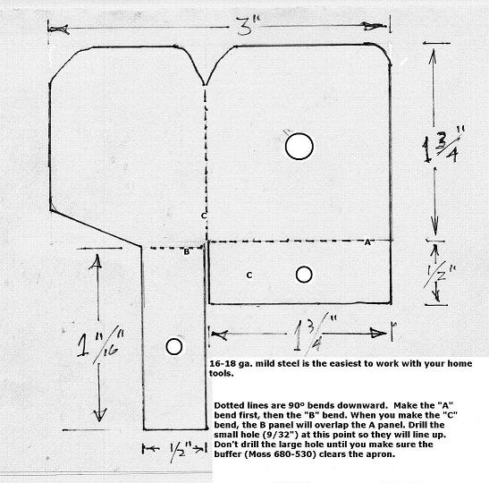

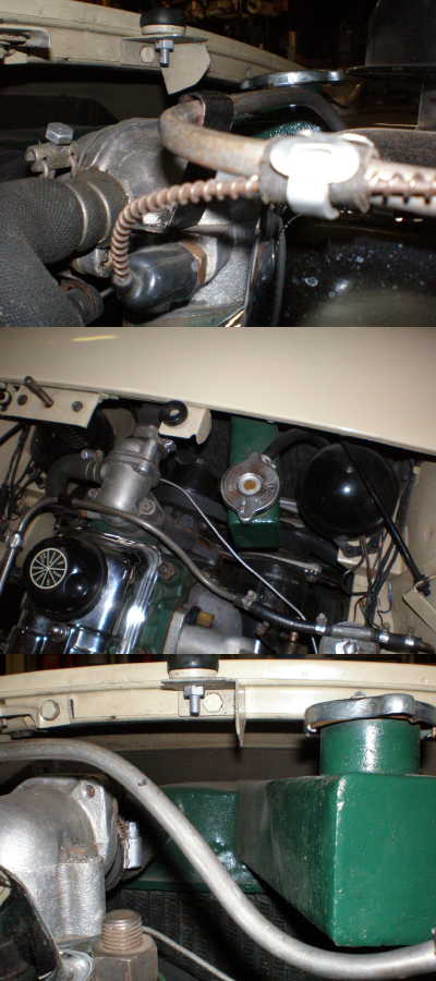

I don't remember any felt but I remember seeing a 3rd buffer on a late 3A or a 3B, so after I did mine, (& was plagued with rattles) I fabricated one & it helped a lot.
I found my sketch in my records box. I'm too lazy to figure out how to include photos here so I emailed them to you.

Here's the pix Frank emailed me. It's pretty much <span style="font-style: italic">exactly</span> what I was thinking!
