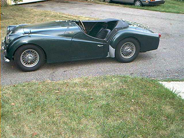

BOXoROCKS
The Tr6 wheels are a good choice,or... find a good set of 60 spk MGB wires,lots around and cheap, get good used adaptors,get a set of 185/70x14 tires, also cheap, and mount on your TR3. It looks beefy and cool and good road handling.All for about the same price as new mini's
BOXoROCKS
posting pix is a drag

I like the look of the stock steel wheels but it is interesting what a difference the various wheel choices make in the appearance of the car.
Even the 14" MGB wires (I cringed when I read that) actually look good, they fill the wheelwell more than I expected.

MGTF1250Dave
Here is link to a picture of my TR3A with MGB wheels and 175SR14 tires on it. The overall diameter of the mounted tire is very close to a 165R15 tire, about 1/2 inch. i needed new tires and friend in my car club offered me a set of 60 spoke chrome wires with good tires mounted for $250.
https://www.britishcarforum.com/bcforum/photopost/showphoto.php?photo=1498
These are similar to Box of Rocks car. I think the beefiness of the tires give the car a robust look.
