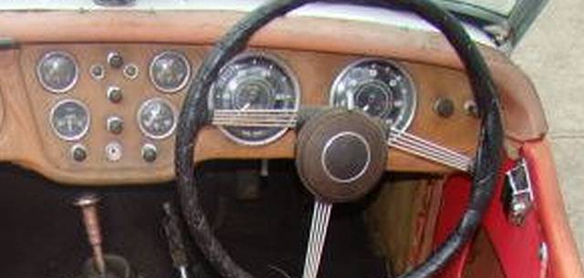

Found a mess of of a TR2 for sale. Right hand drive no less.
Is this correct for a dash layout? Sure looks odd to me.

Looks proper to me.

Me too. The small gauges trade sides to keep the oil pressure & temp nearest the driver.
NutmegCT
Looks proper to me. A 1954, right?
What's that toggle switch farthest right on the dash? <covet covet>

Looks proper to me, too...and looks to be largely original? Any more details or photos? I don't much care for what looks like inexpensive replacement carpet, but the rest looks like the kind of original interior I'd want to preserve as best I could!

Original indeed! That's some serious case of sun-fade of that red vynide!

Shouldn't that area housing the center gauges be black in color? It couldn't have faded that much - could it?

After using Andy's link and zooming on a different photo, I don't believe it's a toggle switch at all. Looks to be an original type heater control, next to an original type OD control. The egg-shaped toggle for the OD didn't come in until later.

Seeing it's got the later thermostat housing, it's likely to be between TS 1201 and 4001. The faded trim is strange and almost looks like a combination of Geranium and Red.
It has the correct cable pull hood release, and trimmed centre guage panel, rather than TR3A crinkle black. As mentioned by others the wing beads should be vynil covered flexible piping.
The push-pull overdrive switch was used on all long door TR2's, and it's arguably worth more with an overdrive, although in long door cars it was a weaker version and only operated on top gear.
It still has the correct low port head and 1.5" SU's, which is fairly rare, as many TR2's are now fitted with high port heads.
Subject to inspection for bondo and the condition underneath, considering it's 56 years old, it looks to be quite unmolested. Decent trim would lift it no end.
