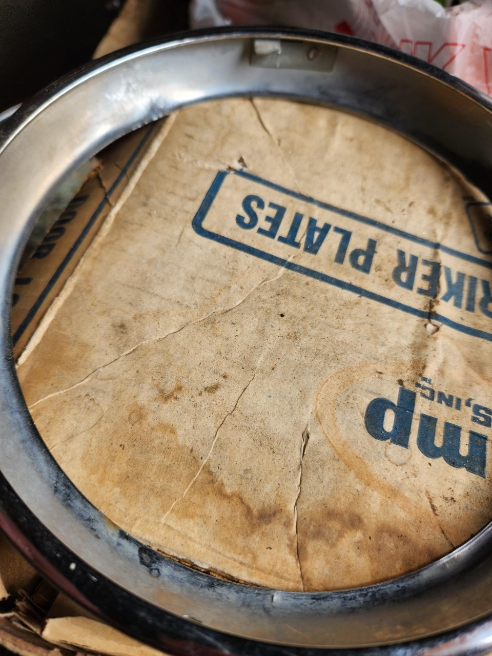

Probably beating up an old topic here, but does anybody know of a source for replacement headlight trim rings with the original type upper retaining tab attached? The owner of the car I'm working on bought replacement rings that not only don't have the clip, but have no hole to install one. I spoke with three prominent parts suppliers whose parts don't have the clip, and seem to not know it ever existed.

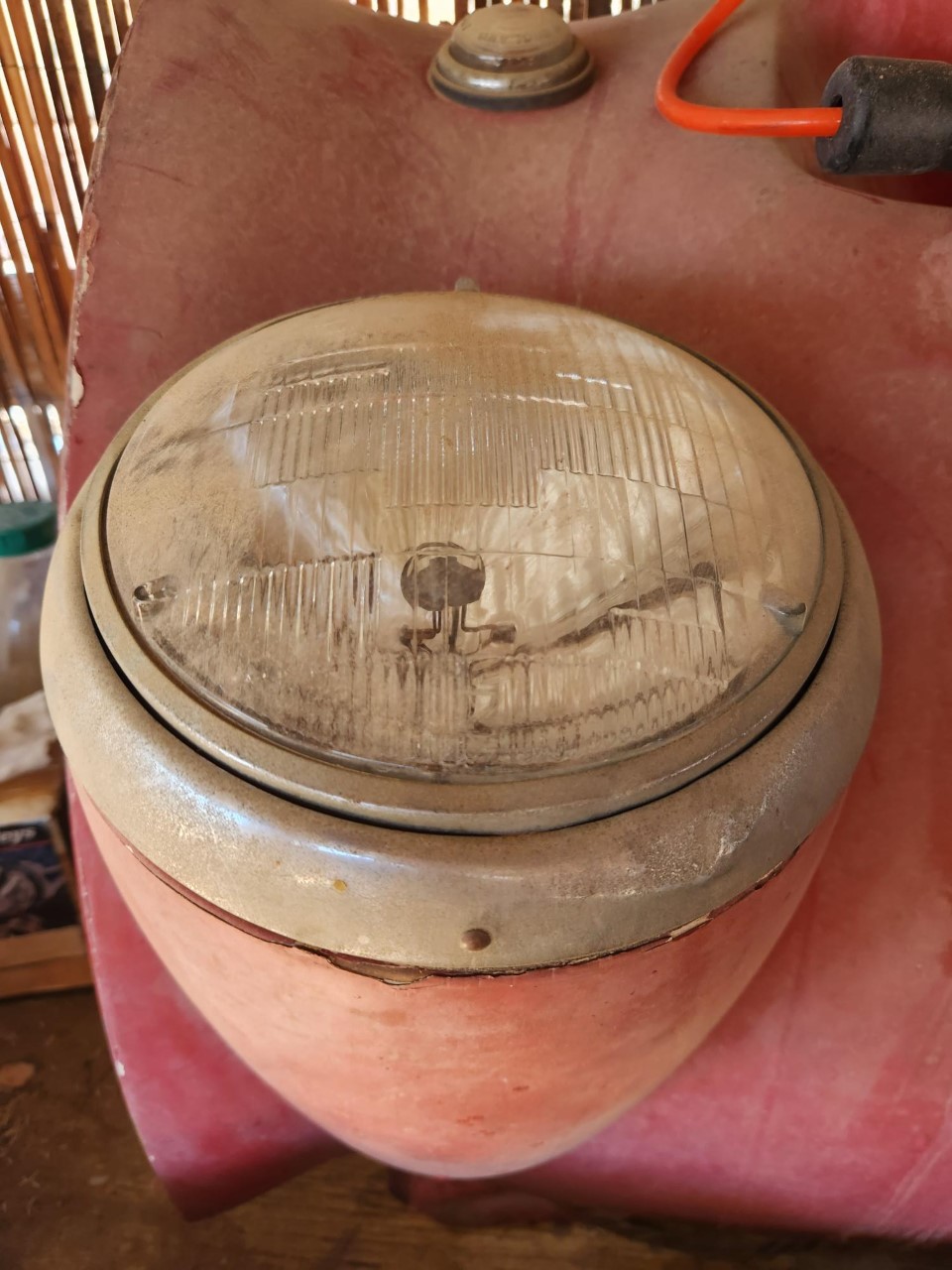

All the small mouths had a screw at the bottom. The screw was easy to get in because the head light sticks out farther on a small mouth. The large mouth did not have a screw at the bottom, but if you are very nimble you can get the screw in place.
For the most part the large mouth was pushed on by holding the top down tight and pushing the bottom in place. The ring was pried off with a tool that comes in the factory tool kit. Most of those had a little stud on the bottom to help with the pop fit plus they can be a real pain to get on and off.
Sometimes when they go on with difficulty is because of a paint build up on the inner piece or the whole headlight has been fastened too tight to the car and does not give enough wiggle room for the ring, or something is bent

Thanks for the input! None of the rings in the link show the clip on the originals, although the "Bezel headlamp rim-alloy" kinda looks like it has a hole where the rivit to install the original clip might go. The wide profile ring looks to have some sort of clip at 9 o'clock in the image, and a rivit head at 3 o'clock, likely for another clip I'd guess. I have two cars here with the same original rings, different from everything I've found.

The attached photo in the original post shows the clip on the inside of the ring.

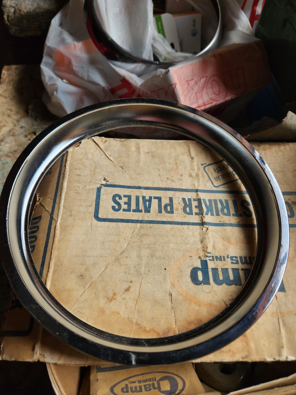

This top-down view shows the rivet.
This is a pic of the inside of the reproduction rings supplied by the owner. It has the screw hole and a couple drain holes on the bottom but no clip or hole for the rivet to hold it. It's kinda hard to see in the pic, but the lip at the rear edge turns up, then forward towards the lens of the light. After much deliberation I decided to try removing that forward pointing lip at about the 11 o'clock and 1 o'clock positions, that allowed the ring to slip behind the ears at the top of the bucket, and some persuasion aligned the hole for the mounting screw.
