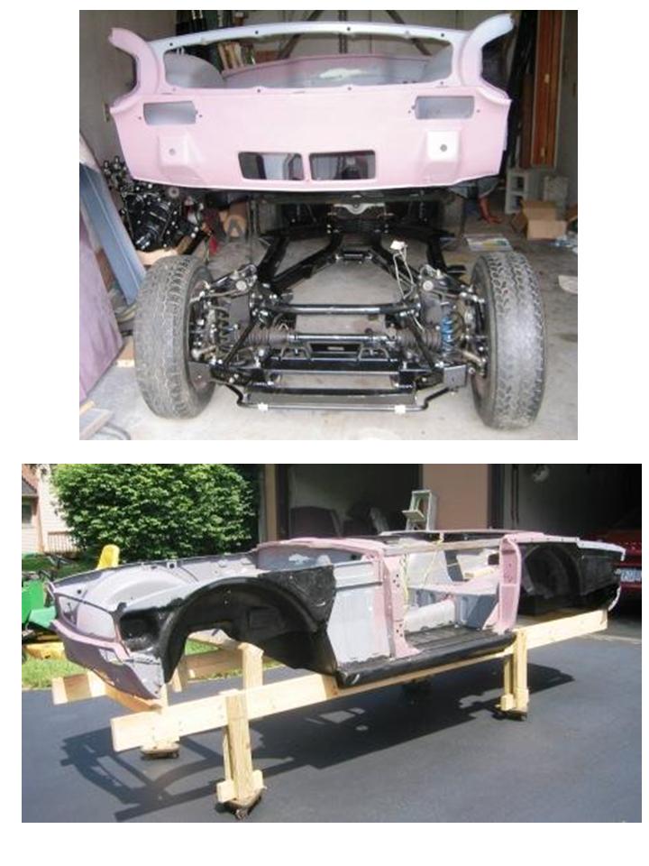

Here's mine being lowered back onto the finshed frame and a pic of the dolly I made to move the body.

DNK
I'd look good with my heals next to that Elliot
Gliderman8
Thanks don... I have a game tonight and now I'll have that thought in my head :pukeface:
