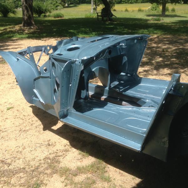

I did my epoxy primer outside on a calm day, but for the color coat on the tub, I built a temporary spray booth with a box fan to draw air out. It worked really well to keep the air clear.
Ed
For spraying the tub, push it out side. I use epoxy primer on everything. I just sprayed the A/H tub this week. Did epoxy primer, let it sit for 30 and then put down color. You don't have to sand between coats. Finish coat, many layers of primer then color. Which all can be done outside, then take to paint shop and let them do finish coat.

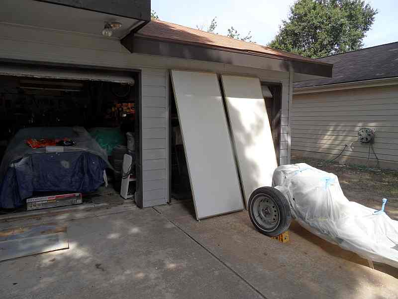

I painted my tub in my 2 car garage with the doors open and a couple panels set against the opening to keep large bugs from flying in. I added an exhaust fan to pull air from the front, and out the rear of the garage. I used tack cloths to wipe down before painting and avoided any other chemicals not purchased from the paint shop (aside from lacquer thinner). I did have a problem on one fender with fish-eyes when I tried to use a less expensive cleaner that I picked up at a local car parts store. I ended up re-sanding and painting that fender a few times -proving to me that not all products are compatible and "cheaper" is not always "less expensive". I purchased a cartridge type respirator because the fumes, even in an open garage, get intense. I also kept the bare skin of my arms covered (cut up old nylon knee-length socks) because over exposure can be deadly. (After a few days of cleaning over-spray off my arms, my skin was over sensitized.) I think I used a box of plastic gloves.
I tried to get everything ready the night before, so I could "shoot paint" first thing in the morning while it was cool. It took a while, because like your plan, I painted incrementally. The inside tub, the outside tub, the doors, the apron, the fenders... each takes a couple days. I had to shoot a base coat of (epoxy) white (after filler-primer) because when I did the inside of the tub, I found the light color (yellow) wasn't dark enough and the grey primer could be seen through several layers of base coat. I always did at least 2 coats of base, and 3 clear (being sure to follow the directions from the manufacturer on mixing, waiting between coats etc). -Before I started painting, my neighbor insisted I first block sand with dry-guide to be sure I had a good surface to start. After a month or so of painting, I wet (or ultra-fine) sanded for another month. It's a lot of work, but if I have to do it again, I'll do it the same way. My paint job would have costed much more than I could afford -as it was I spent a few thousand.

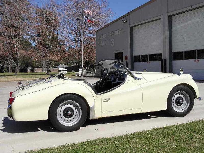

After 18,000 miles and a couple years, it still turns heads and stands up to close examinations. I never used a paint gun before I started on this car. Take your time, research what you're doing and it will come out fine. Be safe and have fun.
