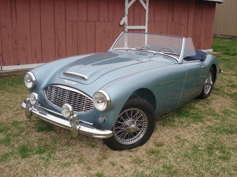

Painted mine last winter with the bead off but the panels mounted. The painter didn't have any problem putting the bead back in and locking up the panels when it dried.
attachment.php
Boy, that's pretty. :encouragement:

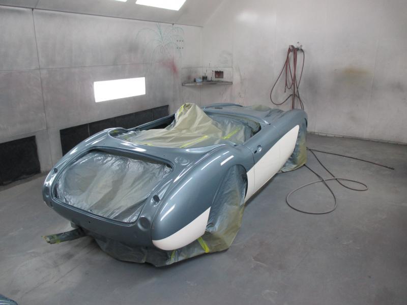

healeyblue
If your painter is experienced he doesn't need to paint them in place. Our car was painted in multiple pieces and even on separate days.

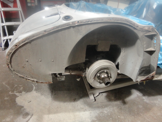

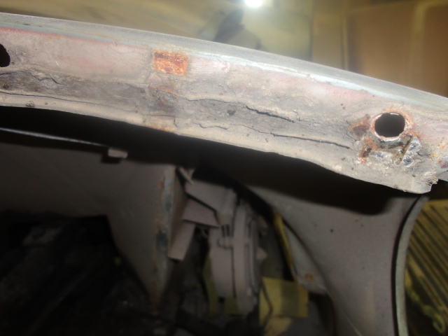

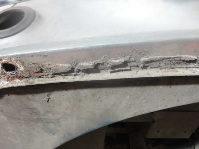

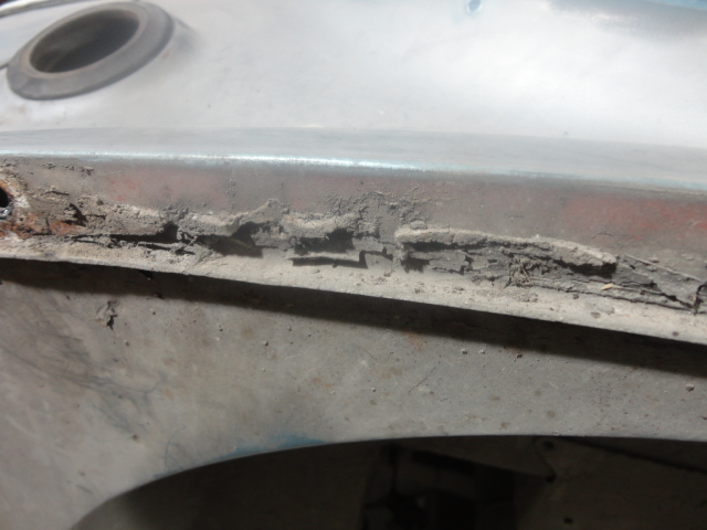

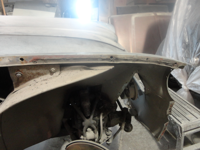

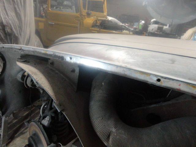

I was able to photograph a early 3000 that had never been apart and I took pics of the sealing material between the front fenders and the shroud and also the rear fenders and the shroud. That bright glare on the front fender is the shiny aluminum on the shroud. The sealing material on the shroud only ran down the fender/shroud so far and then stopped. I couldn't believe how shiny the aluminum was!
With today's coatings, epoxy-chromate primers & catalyzed urethane enamels, I honestly didn't give electrolysis a second thought...
Well, I DID use stainless steel hardware mounting the fenders to the shrouds!
